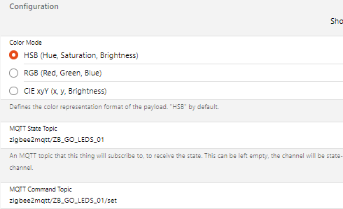

a) which one to use:
b) and here:

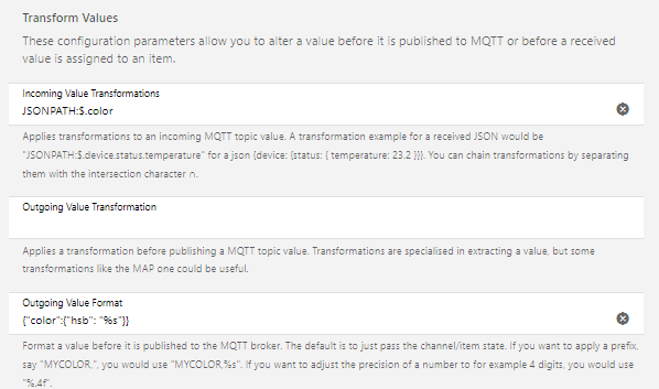

c) and how to define the incoming and outgoing formats:

To a: Use Color Value (HSB, RGB or CIE xyY) (both other options are only for backwards compatibility)
To b: Either use HSB or CIE, but it depends on what’s in the payload of the state topic. So we need some more information here.
To c: I’m pretty sure you will end up with scripts rather than a simple Value Transformation/Format, as neither cie nor hsb is given in a plain format by zigbee2mqtt.
To be clear, you can use the UI to create those scripts :slight_smile:
