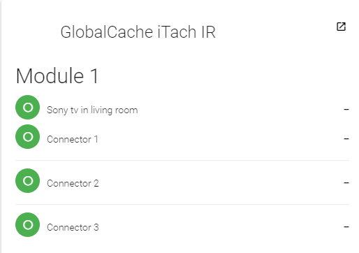

item. i had changed to Switch when playing around. it was the only way i got a switch in the ui.
have changed it back to String and now the switch is gone from the ui

have tried rebooting the raspberry pi with no luck with the switch.

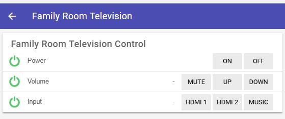

The image you posted above looks like Paper UI. What do you see in the Basic UI? It should look something like this.
thanks Mark,
i am new to openhab so i hadn’t used the basic ui before. took me a bit to work it out but its working now :slight_smile: was only using paper ui.
