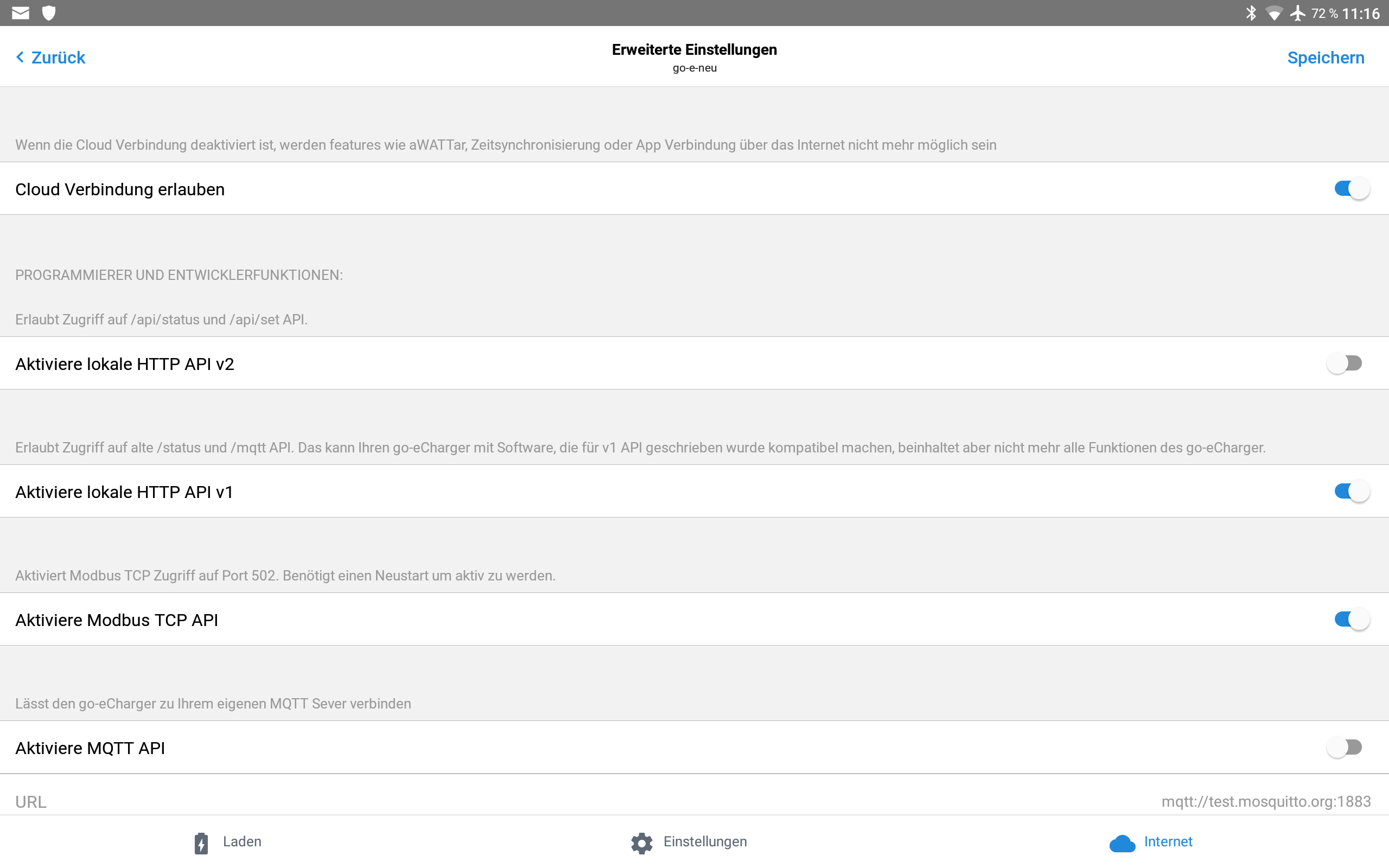

In “erweiterte Einstellungen” I can activate API V2, API V1, Modbus TCP-API - see attached screenshot

You can see this if you call IP/status in a browser, look for eto (totalChargedEnergy) and dws (sessionChargedEnergy).
