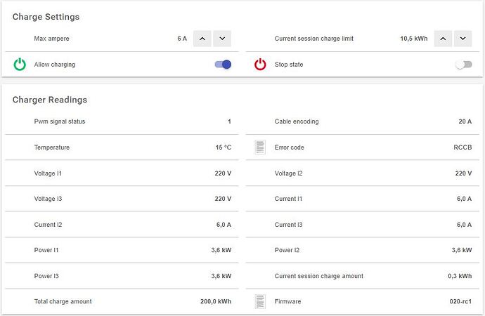

Ok, so i started writing a binding. Its almost complete in an initial version now. PR is here: https://github.com/openhab/openhab-addons/pull/7068
Following values are currently available (created a sitemap with all available values, the top ones are also settable):
Config looks like this:

I just tested it with a real device. Most things directly worked, had to adjust some others. I updated the .jar in the PR. It should now work correctly with the values mentioned above.
Thanks for providing this binding for the go-eCharger to OpenHab.
I tested it and it works just fine.
