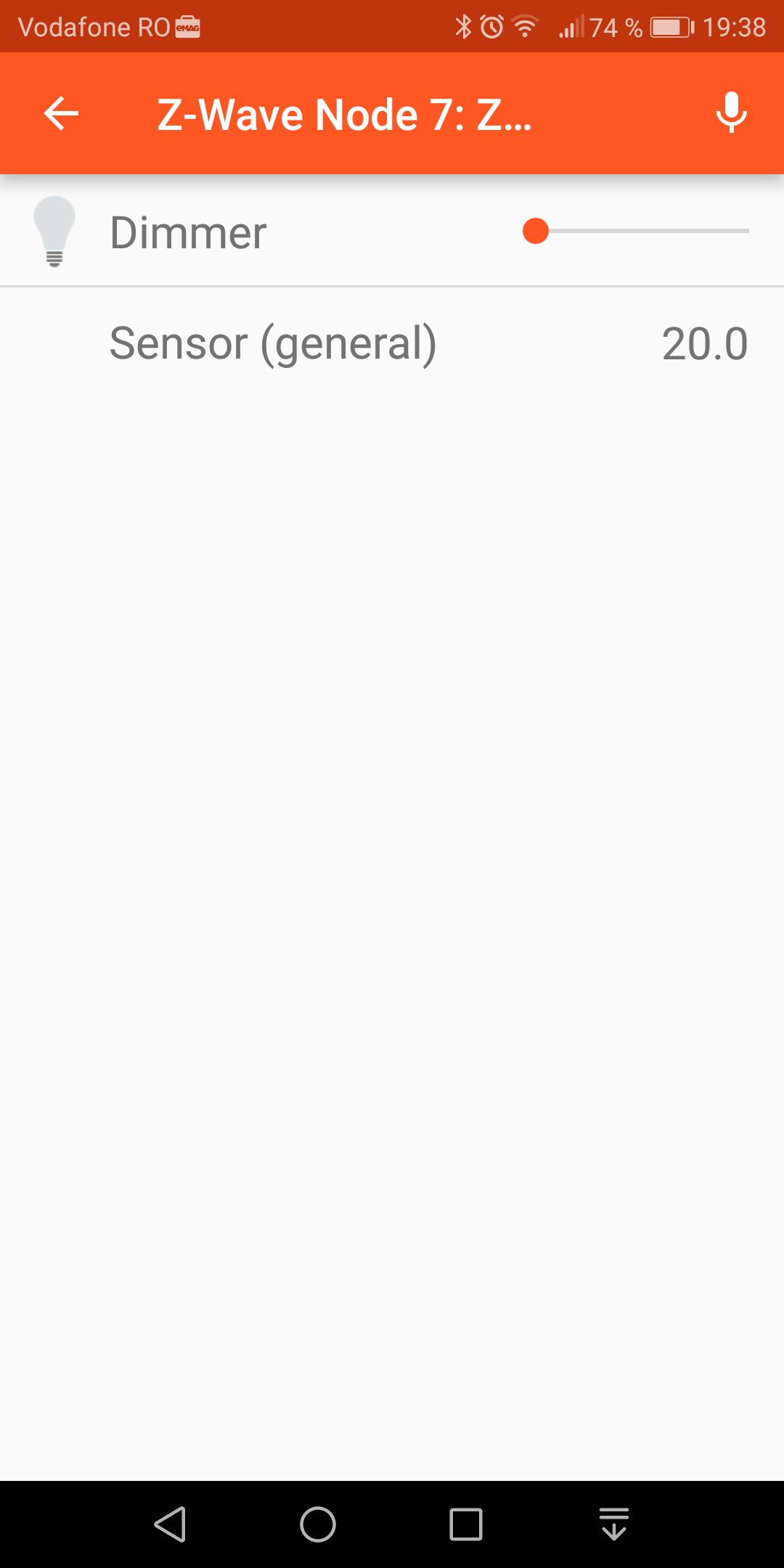

@chris I have attached the xml generated by openhab2 with the completed description.
There should be added a new channel for the sensor multilevel type general:
Sensor (general) SENSOR_MULTILEVEL;type=GENERAL
After modification will be made the readings should be available,

I am satisfied with the result
I control a Belimo actuator that has 0-10v control and 2-10v response
(actually is a damper actuator). I use a Mean Well 24v source to power both
flush dimmer and actuator. The response has a little error: 10v from
actuator is read @98 instead of 100 (adc of flush dimmer has a little
error).
Regards!
