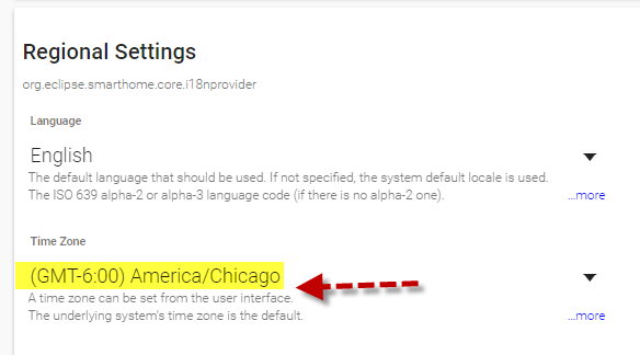

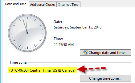

I checked the timezone of the server as well as OH and both appear to set to the correct time zone.
