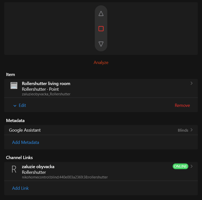

I have managed to control all blinds using google assistant and voice commands as follows:
  • “close all blinds in xyz-room”
  • “open all blinds in xyz-room”
    and so on…
    The items in OH have the correct Metadata, see below:
It is all done using OH Cloud connector to GA service. I am using Niko Home control binding for controling the items.
