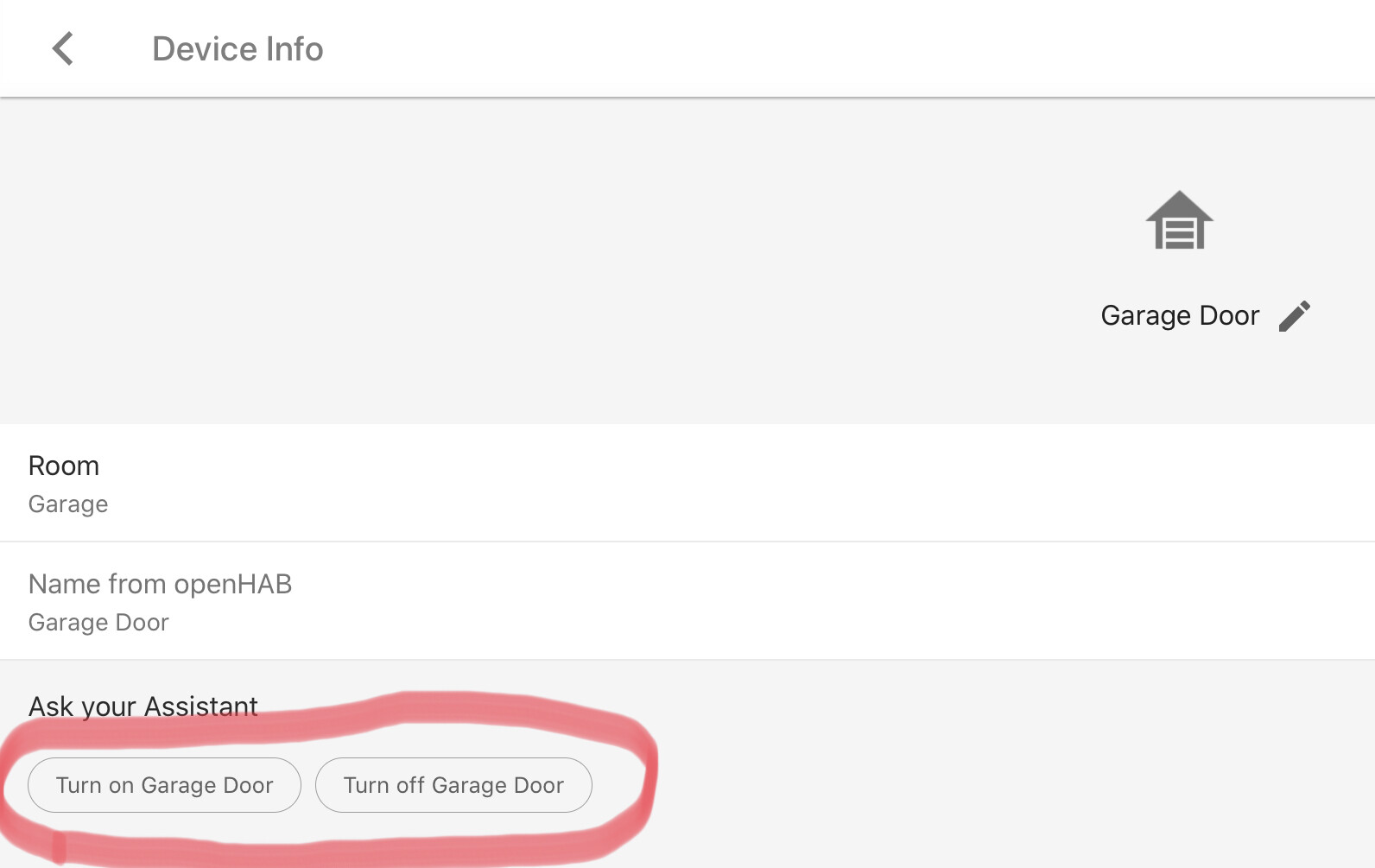

Hello I was able to add / link OpenHab successfully but now I have only one item, a rolling shutter for garage door which shows up in Google as a Garage Door with the Garage Door symbol but below that I only see example commands of Ask to Turn on Garage Door and Ask to Turn Off Garage door. If I click one of those or say it then it works. But if I use a natural Close or Open it does not work. any idea why Rollershutter shows up in Google as a On Off switch?

Here is how it shows in PaperUI :

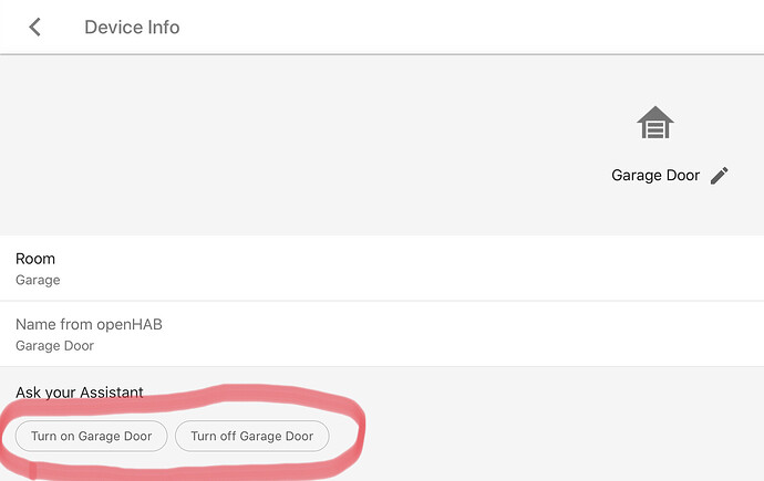

And here is how it looks in google :
It feels to me like it’s an issue on the Google side. There have been bugs that show up in some countries/languages, but not others (similar to how some features are also country-dependent).
What do you see in your log when you send a command via Google Assistant? Is it rollingshutter_GarageDoor changed to OPEN/CLOSED or is it changed to ON/OFF?
