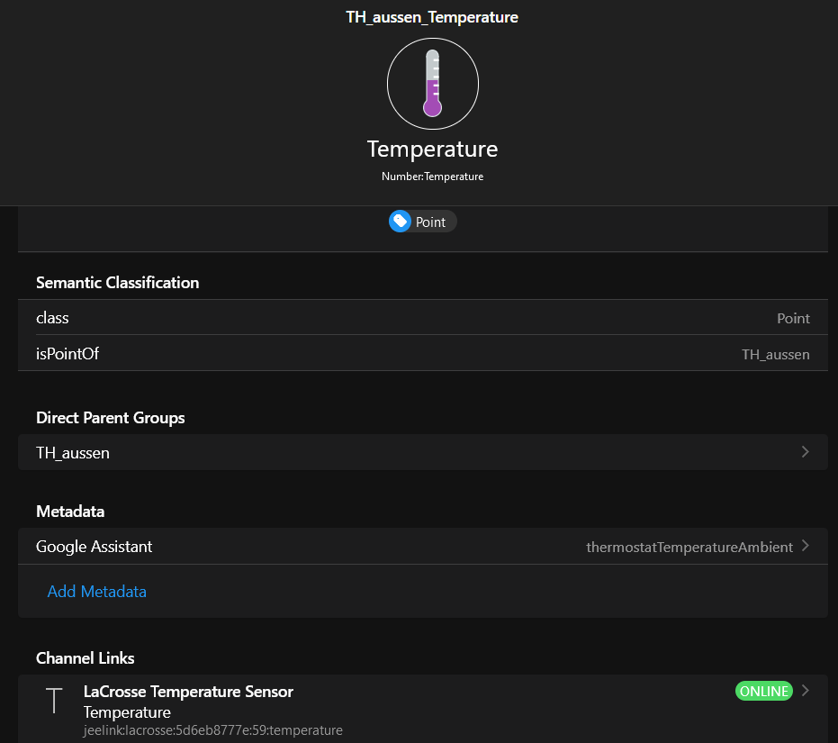

I have the google assistant connected successfully. E.g. blinds are closing and opening by asking google. Now I want to get the temperature of a room via the google assistant.
I added the meta data on the temperature sensor, but it is not working at all. I mainly struggle to figure out the right call and setting and what to ask google. To many things to just try it out ;-). I am using the GUI of openHab.

Interesting that google assistant treats the temperature sensor still as a part of a thermostat. Anyhow, it works.
Btw., I can use the HumiditySensor to get google assistant to speak the state of charge. It just treats it also as part of a thermostat. Sounds funny but I get the value I want.
