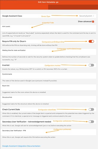

I setup a security switch, this works like the other devices from GA turns on and off fine. I can arm and disarm the switch using GA. But there is no prompt for the password. Not sure what I am doing wrong.
I sync devices on the Google Home. My problem is getting the security pin to work using the UI to create the metatdata GA options.
I create Command option metadata for the Item as:
pinNeeded=“1234”
pinOnDisarmOnly=true
Anyone got this to work using the UI?

According to the docs, these are part of the Google Assistant metadata. Not separate metadata.
Checking “Advanced” shows all the fields including these.

Looked into the JSONDB I see data exists for the security Items GoogleAssistant and Command options created. It exists.
I do check advanced and the Require Pin for Disarm.
All the properties listed in the docs are in the form including pinNeeded and pinOnDisarmOnly.

Works excellent now, GA says “Can I have your pin”, i provide it, it works as expected. Great keeping my partner in crime happy she does not have to enter a pin to turn on security.
So it is clear this works from the UI, no item hardcoding required!

All metadata would have needed to go into the “Google Assistant Metadata” of the SecuritySystem item.
Like:
value: SecuritySystem
  checkState: true
  pinOnDisarmOnly: true
  pinNeeded: '1234'
