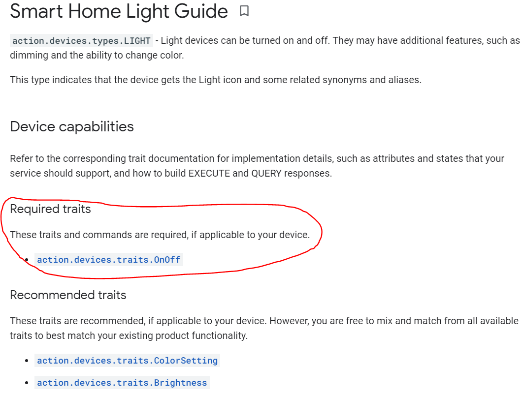

Waiting for someone else to reply, i would just like to pinpoint that the documentation (Google Assistant | openHAB) clearly highlight the existence of an optional lightpower attribute
but this attribute does not exist into the semantic model page
And by checking the ga documentation page for lights “Cloud-to-cloud  |  Google Home Developers” it seems that the above attribute is the required one in place of the other two. (i am not saying this is the root cause of the issue but just highlighting some mismatching information)

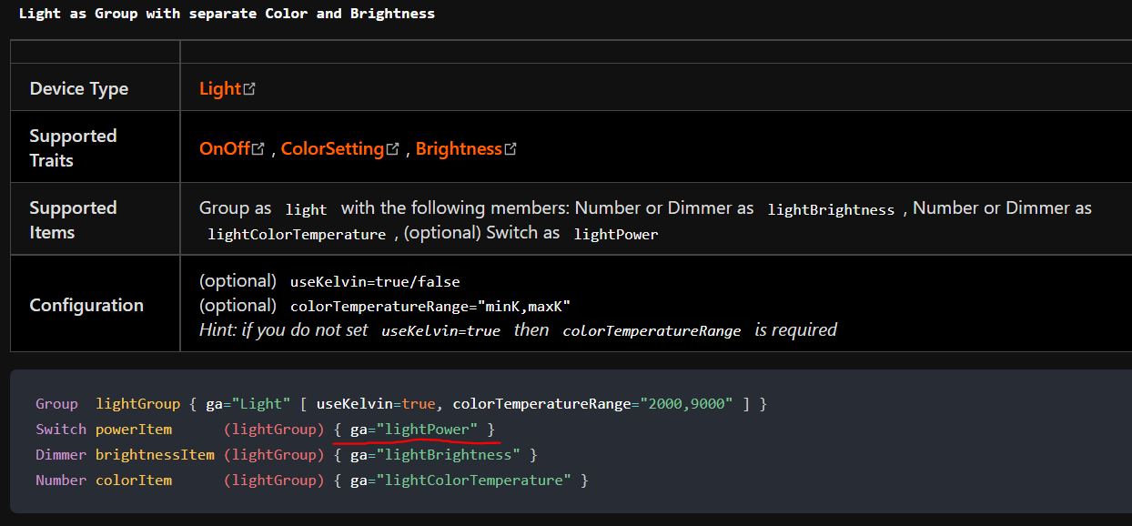

Thanks for your response! I did notice as well that the “lightPower” attribute was missing. I actually thought it might be a UI quirk so tried to create the same items directly in an “.items” file and use the lightPower attribute there:
The items were indeed created and I can see them in the UI:
however this light group still does not appear in Google assistant / Google Home App. :frowning: I wonder if developers working on Google assistant plug in for OpenHab could comment on the root cause. I wonder if we are missing something obvious as this is a basic set up for Hue colour bulbs…
