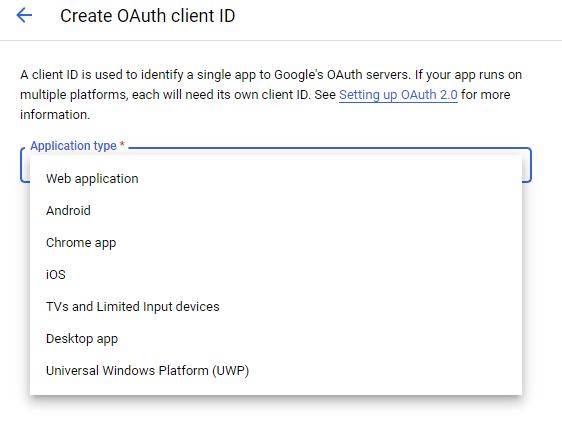

Hi!
I have a problem setting up authentication code on Google-Cloud-TTS service in openhab3. In the wiki I need to get an auth code from Google Console. If I click Create Credetials → OAuth Client ID I have no option of Application type Other .
How to proceed further?
Thank you,
Zsolt.

I do not have experiences with it.
From the options that you have I would suggest to use either “TVs and Limited Input devices” or “Web application”.

This works. Thank you. I think the wiki should be updated.

I tried but i keep getting Google hasn't verified this app when i try to get the Authorization Code.
Than i realized i need to click Advance at the bottom to go further.
