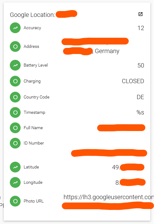

Things, items, and transforms
.things file
//NAME Location
Thing mqtt:topic:googlelocation_NAME "Google Location: NAME" (mqtt:broker:e0c4d01e) @ "Server Room"{
Channels:
    Type number   : Accuracy         [ stateTopic="googlelocation/NAME/accuracy"]
    Type string   : Address          [ stateTopic="googlelocation/NAME/address"]
    Type number   : Battery_Level    [ stateTopic="googlelocation/NAME/battery_level"]
    Type contact  : Charging         [ stateTopic="googlelocation/NAME/charging", on="True", off="False"]
    Type string   : Country_Code     [ stateTopic="googlelocation/NAME/country_code"]
    Type datetime : Timestamp        [ stateTopic="googlelocation/NAME/datetime", transformationPattern="JS:googletimestamp.js"]
    Type string   : Full_Name        [ stateTopic="googlelocation/NAME/full_name"]
    Type string   : Id_number        [ stateTopic="googlelocation/NAME/id"]
    Type number   : Latitude         [ stateTopic="googlelocation/NAME/latitude"]
    Type number   : Longitude        [ stateTopic="googlelocation/NAME/longitude"]
    Type string   : Photo_URL        [ stateTopic="googlelocation/NAME/picture_url"]
.items file
//NAME Location
Number   GPSLocation_NAME_Accuracy       "Accuracy"       (Logged) {channel="mqtt:topic:googlelocation_NAME:Accuracy"           }
String   GPSLocation_NAME_Address        "Address"        (Logged) {channel="mqtt:topic:googlelocation_NAME:Address"            }
Number   GPSLocation_NAME_Battery_Level  "Battery Level"  (Logged) {channel="mqtt:topic:googlelocation_NAME:Battery_Level"      }
Contact  GPSLocation_NAME_Charging       "Chargin"        (Logged) {channel="mqtt:topic:googlelocation_NAME:Charging"           }
String   GPSLocation_NAME_Country_Code   "Country Code"   (Logged) {channel="mqtt:topic:googlelocation_NAME:Country_Code"       }
DateTime GPSLocation_NAME_Timestamp      "Timestamp"      (Logged) {channel="mqtt:topic:googlelocation_NAME:Timestamp"          }
String   GPSLocation_NAME_Full_Name      "Full Name"      (Logged) {channel="mqtt:topic:googlelocation_NAME:Full_Name"          }
String   GPSLocation_NAME_Id_number      "ID Number"      (Logged) {channel="mqtt:topic:googlelocation_NAME:Id_number"          }
Number   GPSLocation_NAME_Latitude       "Latitude"       (Logged) {channel="mqtt:topic:googlelocation_NAME:Latitude"           }
Number   GPSLocation_NAME_Longitude      "Longitude"      (Logged) {channel="mqtt:topic:googlelocation_NAME:Longitude"          }
String   GPSLocation_NAME_Photo_URL      "Photo URL"      (Logged) {channel="mqtt:topic:googlelocation_NAME:Photo_URL"          }
