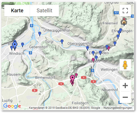

I did a major refactoring of the map display to make it more flexible and easier to use. It uses now ajax/xhr to update the positions (without the need to reload the page). Also some decent animation was thrown in.

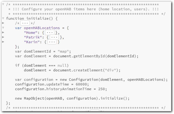

To configure add your Google API key in “index.html”. The markers can be configured in “./lib/map21.js”:
You can configure as many elements as you need.
