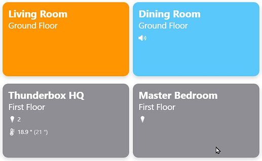

I have a number of Google Nest speakers around my house, linked to OpenHAB via the Chromecast extension.
I’d like the location card for the relevant room to show the speaker badge if they are playing.
I have it working for the amplifier in the dining room, where OpenHAB is using the power state of the device. But as the Nest speakers are linked via chromecast, they don’t have this channel.

I’m new to OpenHAB… but I stumbled across the transform profile settings this afternoon and after installing the MAP transformation add-on I got your idea to work perfectly!
