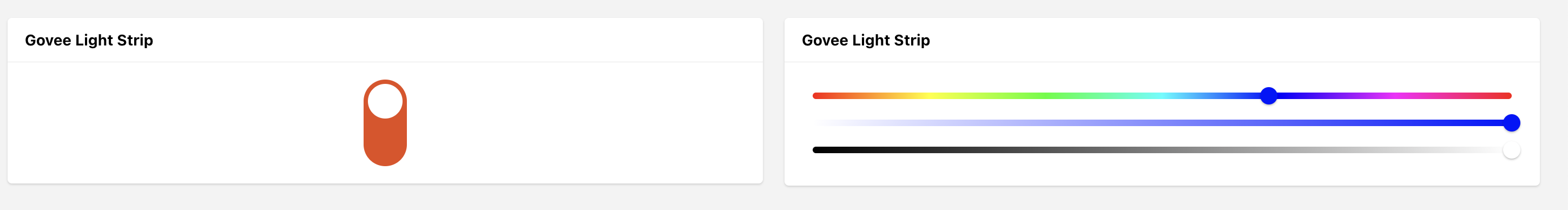

The HSB sliders aren’t working right. In the image the puck is in the dark blue range of the slider but it’s more like cyan and the light itself is about cyan but the saturation seems low compared to what that slider is indicating. It’s like it’s lost track of what’s going on and just guessing against the changes I make on the sliders.
I kinda remember another device that had a setting that was being read/written inversely to what it needed. This seems like a similar problem but I don’t recall what the device was or where to set it so it was manipulated properly.
I have the light strip setup and these two widgets:
The light is dark blue on this setting. What is weird though, that your slider knob is actually a different color than the color of the bar underneath. I checked it on my notebook and even resized the page to become much smaller - it works. And it also is fine on my Android app.
Ups… why did you delete the posting?
Just deleted the post, I had set up the page with those widgets wrongly. Wiped that config and started again it’s all working as expected now. PEBKAC issue.
