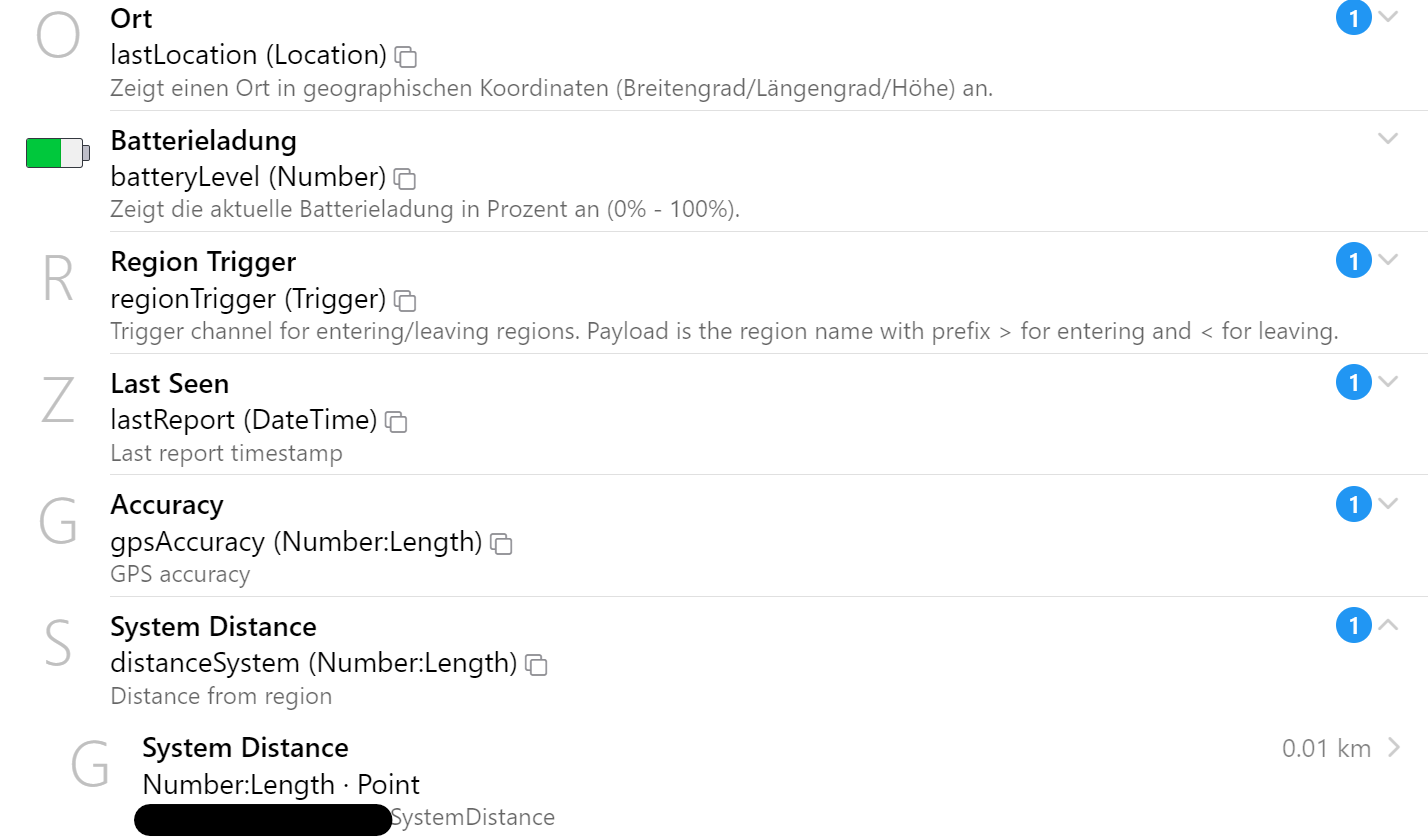

In the event.log I’ve the following entry:
2022-11-22 17:32:39.882 [INFO ] [openhab.event.ItemStateChangedEvent ] - Item 'GPSPhone_SystemDistance' changed from 4.372936947680441 km to 0.014105295176936124 km

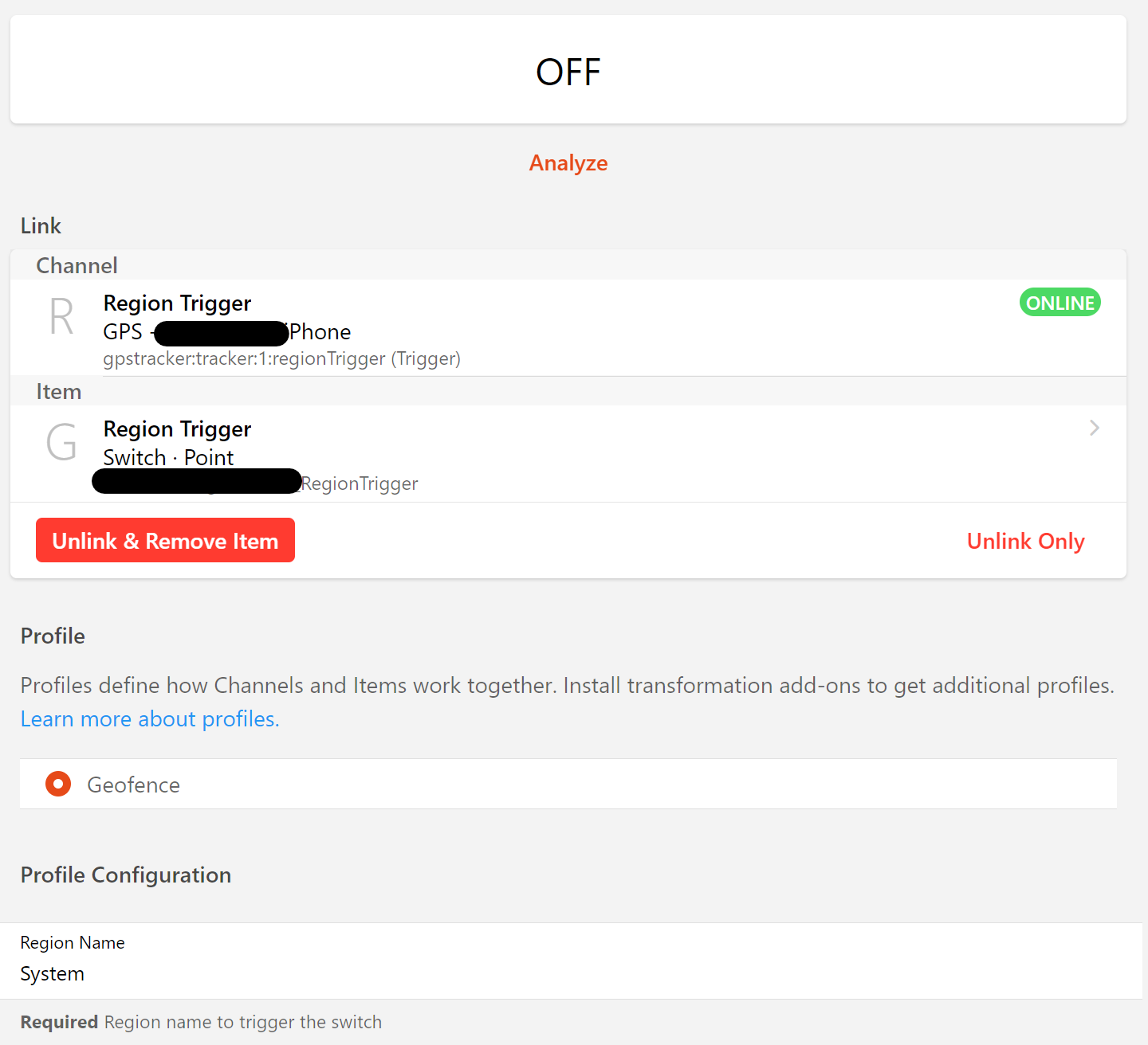

This means, that I am ~15m away from the region’s center and within the given system distance of 35m. But the system region trigger is still set to OFF:

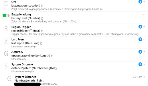

Just to make sure, my current system center distance:
Most of the time it’s working like a charm but sometimes my location has been updated properly, but the region trigger has not.
Any ideas?
