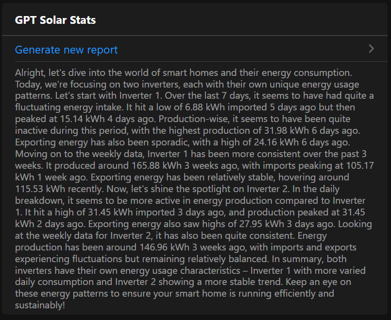

My first rule written with GPT, to feed the OpenHAB GPT binding to create reports about my solar pv systems.
I’m sure the code is janky, I had to make a few manual tweaks to make it work, and I think I can tweak his personality a bit more before I’m done, but it works!
I want to add the error logs, some of the Live Production values, weather, heat pump data and anything else that is difficult to see the big picture of.
Ideally we could get to a place where GPT just takes the entire events.log and openhab.log down it’s neck.
I don’t have much data yet, and the inverters have been on and off a lot recently while some work is being done in the house.
GPT Binding Chat System Message:
You are a smart home. I will give you stats and you will give me a report. make comparisons, note highs, lows, trends, and anomalies. ignore null or missing data. make it a conversational summary. Units are kWh. Uses relative dates eg 3 days ago. Round numbers to make them easier to read. Be entertaining in the delivery. Infer other data from the data provided and look for possible errors.

Overall there’s more repeated code than I usually like to see but over all I don’t see anything glaringly problematic. ChatGPT has come a long way. They must have injested more recent docs and examples. :smiley:
