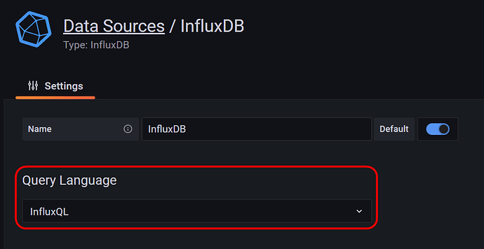

In my old installation of Grafana (6.4.2) , I had the possibility to select the measurements via a dropdown
In my new installation I only have the possibility to use ‘flux code’ or I don’t know how to switch to the old interface.

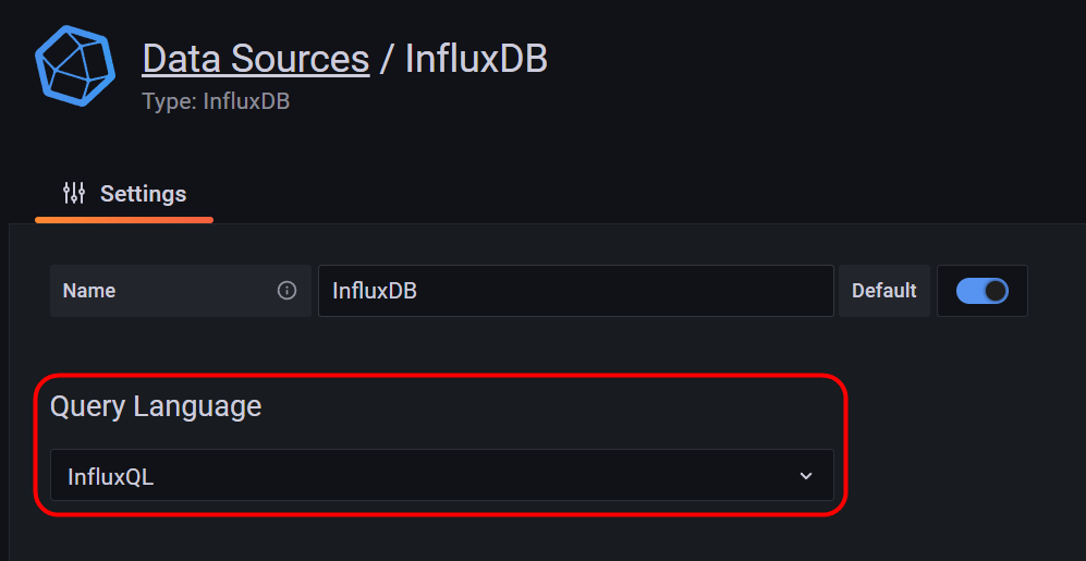

You can configure the query language in your data source in Grafana. I have one for “InfluxQL” and one for “Flux”. If you select “InfluxQL” you should get your dropdowns.
