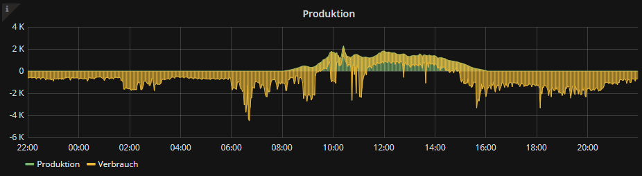

Something like that?
This is Power production minus Power consumption.
But I have to admit, that Consumption is stored with negative value. I have no Idea if it’s possible to do more math in grafana, this graph is “two channels stacked”.

Yep. got found this “stack” option.
Sadly the non-heated water is still a positive value and grafana keeps on sum-function, so as result i get the non-heated water, heated water and even super-heated water :grin:
