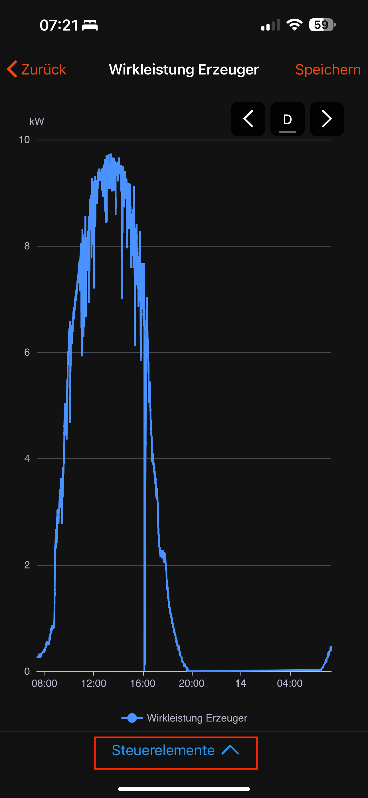

for a little workaround brought the graph back on iOS.
If I open and close the settings of the graph on the bottom the graph is visible again.
Maybe it also helps you until the new release is out.
