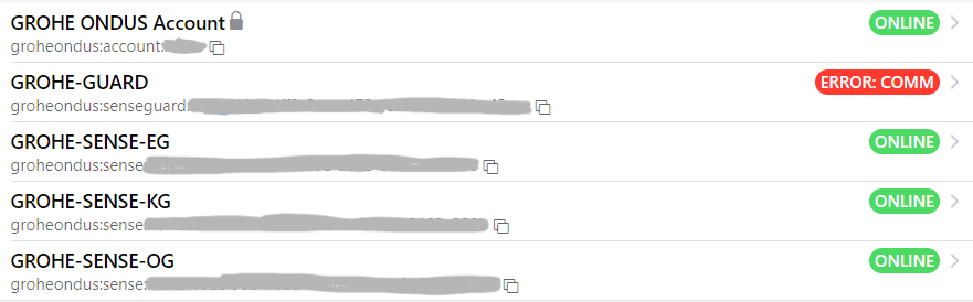

i’m using openHAB 4.1.0 Build #3675
since some weeks the sense guard is no longer working, the bridge itself and the sense devices are working:
the sense guard comes up with “Could not load data from API.”
Anything i can do here?

in the log i see:
java.lang.NullPointerException: Cannot invoke "java.util.List.isEmpty()" because "measurementList" is null
at org.openhab.binding.groheondus.internal.handler.GroheOndusSenseGuardHandler.getLastMeasurement(GroheOndusSenseGuardHandler.java:139) ~[?:?]
at org.openhab.binding.groheondus.internal.handler.GroheOndusSenseGuardHandler.updateChannel(GroheOndusSenseGuardHandler.java:91) ~[?:?]
at org.openhab.binding.groheondus.internal.handler.GroheOndusSenseGuardHandler.updateChannel(GroheOndusSenseGuardHandler.java:1) ~[?:?]
at org.openhab.binding.groheondus.internal.handler.GroheOndusBaseHandler.lambda$1(GroheOndusBaseHandler.java:119) ~[?:?]
at java.lang.Iterable.forEach(Iterable.java:75) ~[?:?]
at org.openhab.binding.groheondus.internal.handler.GroheOndusBaseHandler.updateChannels(GroheOndusBaseHandler.java:119) ~[?:?]
at java.util.concurrent.Executors$RunnableAdapter.call(Executors.java:539) ~[?:?]
at java.util.concurrent.FutureTask.runAndReset(FutureTask.java:305) ~[?:?]
at java.util.concurrent.ScheduledThreadPoolExecutor$ScheduledFutureTask.run(ScheduledThreadPoolExecutor.java:305) ~[?:?]
at java.util.concurrent.ThreadPoolExecutor.runWorker(ThreadPoolExecutor.java:1136) [?:?]
at java.util.concurrent.ThreadPoolExecutor$Worker.run(ThreadPoolExecutor.java:635) [?:?]
at java.lang.Thread.run(Thread.java:833) [?:?]
Looks like API was updated and some data fields are shifted/renamed. Please report issue at github.
there seems to be an existing bug, i added a note there. hopefully somebody can have a look. Sad that grohe API isn’t well documented, at least i didn’t find anything.
