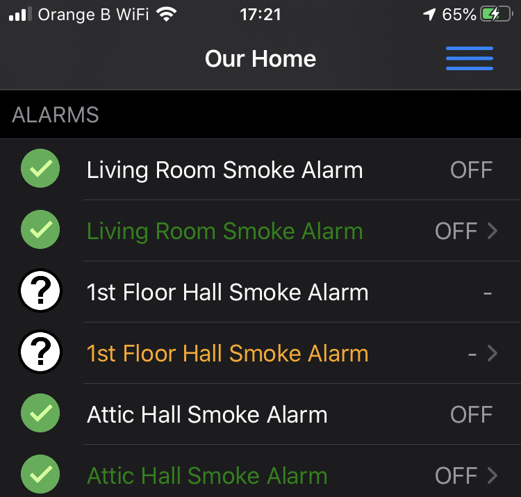

However, my sitemap tells me otherwise. The textual representation of the aggregation group state is ‘-’ (which happens to be NULL) which is unexpected.

Here’s a screenshot of the reported states:

No bug.
All Items, including Groups, begin life at boot time with a state NULL.
That’s the way it stays until something happens.
In the case of a group, one of the members needs to change to trigger the group aggregation function to calculate.
There is also state UNDEF which I think can be imposed on a group with a nonsense type/members/function combination.
As you hopefully don’t expect fire alarms to trigger very often, and battery zwave devices might not even report OFF daily, you can narrow down your interest in group state to be “ON or not-ON”.
Rules, icons, texts etc. can all be set up to work in that way.

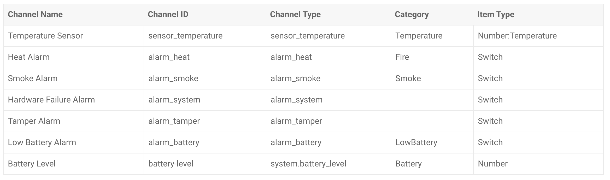

Since the smoke sensors I’m using are Fibaro FGSD-002 Z-Wave devices (firmware version 3.3), I’d like to know if @chris can tell whether it is okay to define the alarm items as Contact instead of Switch.
The device supports the following items -:
The alarm is defined as a Switch so you need to use this.
