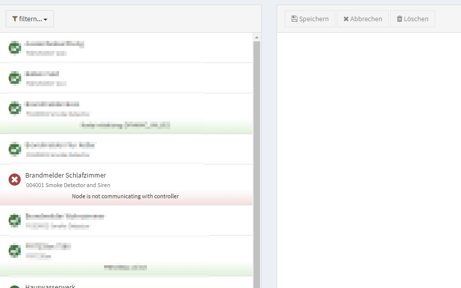

The Smoke Sensor is marked like this:
Do you have any idea, whats going wrong?

If I want to turn on siren:
7-10-27 16:20:53.104 [hingStatusInfoChangedEvent] - ‘zwave:device:020e4758:node16’ changed from ONLINE to OFFLINE (COMMUNICATION_ERROR): Node is not communicating with controller
2017-10-27 16:20:56.341 [ItemCommandEvent ] - Item ‘i_zwave_16_Sirene’ received command OFF
2017-10-27 16:20:56.350 [ItemStateChangedEvent ] - i_zwave_16_Sirene changed from ON to OFF
And than the device is offline again
