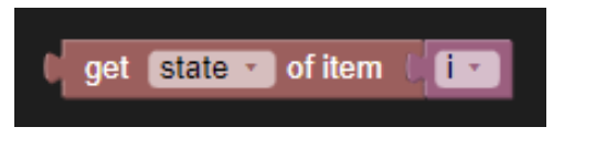

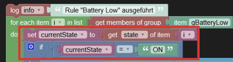

I just bumped into this issue with a similar solution-in-mind as Christian, I wanted to check the battery status of my blinds. Thanks for the workarround!
I’m not sure if it’s clear from the discussion above. In the loop, this works:
But this doesn’t work:

In the loop, this works… but this doesn’t work:
can you give an example where the two blocks behave differently along with the code it creates, so I can investigate it?
If you use both blocks wit Items they behave the same, but if you use them with a variable they are different.
itemRegistry.getItem('MyItem').getState();
var i_list = Java.from(itemRegistry.getItem('MyItem').members);
for (var i_index in i_list) {
  i = i_list[i_index];
  logger.info(itemRegistry.getItem(i).getState());
  logger.info(i.getState());
The first block is checking the itemRegistry for “i” but the variable is not stored in the itemRegistry
The second block is, as you said “smart”, and is just checking “i” for it’s State.

That’s what i figured out.
It is the same with this block
If you connect a variable you get a warning, it is the same warning as i posted above.
this workaround is working
I just experienced the same on openHAB 3.4.2. Thanks for the workaround.
