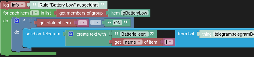

Now i want to send a message if the items state is ON. The scripts looks like this:
But this doesn’t work:
java.lang.RuntimeException: org.openhab.core.items.ItemNotFoundException: Item 'LivingRoom1_BatteryLow (Type=SwitchItem, State=OFF, Label=Batterie leer, Category=null, Groups=[gBatteryLow, gLivingRoom])' could not be found in the item registry

Caused by: org.openhab.core.items.ItemNotFoundException: Item 'LivingRoom1_BatteryLow (Type=SwitchItem, State=OFF, Label=Batterie leer, Category=null, Groups=[gBatteryLow, gLivingRoom])' could not be found in the item registry

OK, here’s the problem. When you iterate over the members of a Group, you get the actual Item Object. “get state of item” is expecting the name of the Item. I’ve not done much with Blockly yet but to make this work you either need to either get i.state instead of “get state of item i” or you need to use “get state of item i.name”.
@stefan.hoehn, I wonder if there would be a way to make “get state of item” work with either the Item name or the actual Item. For example maybe something like this could work:
var GenericItem = Java.type.("org.openhab.core.types.GenericItem"); // I'm guessing at the class path here
(i instanceof GenericItem) ? i.state : items[i];

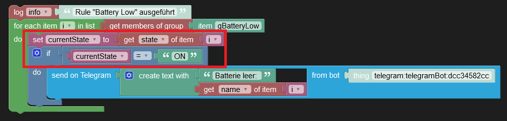

I changed the rule like this:
I can’t directly use “get of item” in the if condition. So i have to set the state in a variable, but it works now.

First of all, I had to look what is happening and I will explain that (which is partly, I am sure, what you meant, Rich).
Buckle up, the explanation becomes a bit complicated (and bear in mind the time of writing :zzz:)
First let’s look at this
A) Why doesn’t “get xxx of item” connect?
This actually depicts an issue I have described in the blockly reference as a bug. Unfortunately a wrong blockly output type was used which does not allow the block to connect. There is a bug fix PR already waiting. Depending on the chosen attribute it now produces either a String or an oh_item, which works well.
The reason you made it possible to work with is via the Variable-Workaround which basically tricks blockly and let’s you assign anything which is a workaround for that bug. Hence, you can use it in any block and therefore in your if-statement.
B) Why does “get state of item” throw an exception?
First, the log works because it just asks any given block to produce its String-representation. That is why it works.
Now let’s look the following two examples in the for-loop:
with the related code that is generated
var member_list = Java.from(itemRegistry.getItem('Lights').members);
for (var member_index in member_list) {
  member = member_list[member_index];
  logger.info(itemRegistry.getItem(member).getState());
  logger.info(member.getName());
The second line in the loop uses (the bug fixed) “get xxx of item”, which is a more generic version of the up to now existing “get state of item” in fact expects a “oh_itemtype” as an input type and references the following block which produces “itemRegistry.getItem(‘MyItem’)”
oh_itemtype
As a result the block
“get state of item” image
wants you to only allow the oh_itemtype to be attached like so
I just noticed that can even attach a thing-block which is hard to be prevented because neither the thing- nor the item-type is “typed”, so it connects everywhere. I am hesitant to add type-awareness to these at the moment because I fear the side effects that might break zillion other places
Anyways, as you can see above, if you use the right block it expects (a real item) it produces

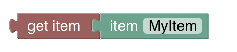

because the “real item” produces
itemRegistry.getItem('myItem")
So why does the first line then throw an exception?
Well, it expects not a “real item” but only the item reference (the green block) which simply produces ‘myItem’ but member is not a String but an Object, so you get an exception (you cannot ask the registry to retrieve an item by providing an item).
But why does it then allow you to put into that block if it throws an exception?
The reason is that blockly assigns that to a variable which then loses its type in the code. So during the code generation I (the programmer of the blocks) have no clue what code should be generated (with our without itemRegistry). So the only smart idea (and now I am back at Rich) would be to generate a code that is capable of working with both by checking the type during runtime (by the way, Rich uses the new Javascript engine here with item which is not yet supported by Blockly… I know Rich :wink: )
In summary, yes, Rich, it can be done because the whole situation above is too hard to explain anyone, so it must become more fool proof internally. Hence, I started a Proof of concept (even more :zzz:) and I was able to achieve that:
So both ways work now because it produces the following code (which doesn’t look nice but at least does work behind the scenes):
  logger.info((member instanceof org.openhab.core.items.GenericItem) ? member.state : itemRegistry.getItem(member).getState());
logger.info(('Lights' instanceof org.openhab.core.items.GenericItem) ? 'Lights'.state : itemRegistry.getItem('Lights').getState());
I also changed this for the “get xxx of item”-block.
The fix is now part of [blockly] Fix item.getAttributes by stefan-hoehn · Pull Request #1254 · openhab/openhab-webui · GitHub
(i have added this thread to Blockly Reference as a known issue)
