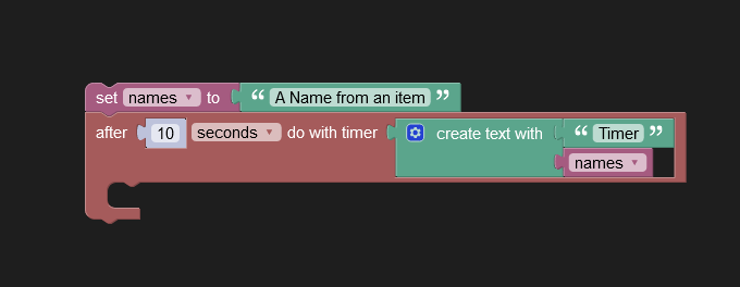

Hi @Rolli.
i think the problem is, that you use one timer for all items. In my opinion a timer can only have one function. Until the timer is not finished you can’t use it again.
So what you can try is to create in every loop another timer for the specific item:
Can you report if it worked?

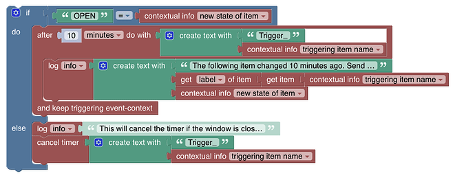

In addition to previous post I would add that you do not even need to iterate through the entire group of windows or lights.
If I understand correct eg. if 1 of x windows will be open, you only want to send a message for this specific window.
For this usecase you can use “when a member of the group changes” as rule trigger and within the rule you can use the contextual info (what will give you the name of the window that was opened).
If multiple windows will be opened at the same time, the contextual info will get overwritten, and therefore you need to pass the event to the Timer (otherweise the timer will always only know the window that was opened / closed latest).
Simply use the timer in this library (instead of the ootb timer in blockly) what will solve the issue with the context (as I’m doing exactly the same).
Removing your loop would make your rule faster and more easy to read, as there is no need to always check all windows and OH will tell you which window was opened / closed.
For the light you can do the same or, if you always want to turn off the light after a specific time, e.g. 10 minutes, simple use the expiration timer metadata and you do not need to have a rule at all.
@Christian_Kittel
Hi Christian, thanks for your answer and for the hint with the variables, i tryed your solution unfortunately
it´s not working. The timers are created, in my test case 2 timesr, but still send the command, 2 times, to a groupmember which is not ON.
@Matze0211

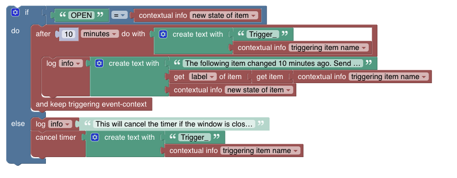

The error you mentioned is already fixed. Please make sure to use the latest version.
(While testing I had ootb timer and the custom timer in one rule to compare both, therefore I only recognized this issue after testing)
You can delete the library from Developer Tools → block library and just add it again via the marketplace or manually copy to be library code to your system.
Could you paste JavaScript and an image of yout Blockly again?
Thats what I would recommend instead of looping through the group (if you want to notify about open windows immediately you can remove the timer and just use the “contextual infos” blocks to replace your loop.

        type="oh_context_info" id="0m#pH`8`G!eqL~f]Yp=p"><field
        name="contextInfo">itemState</field></block></value></block></value><statement
        name="DO0"><block type="commonBlocks_timerWithInitialEvent"
        id="UW]t::9XoUT}i?(KwpKb"><field
        name="duration_unit">plusSeconds</field><value name="duration"><shadow
        type="math_number" id="#wQS=ZqB0{Ncp#RTlqJb"><field
        name="NUM">10</field></shadow></value><value name="timer_name"><shadow
        type="text" id="]4e0My{k|hMNjd!ghvRo"><field
        name="TEXT">MyTimer</field></shadow><block type="text_join"
        id="Y2^KEP3I6A,JETbiPz0w"><mutation items="2"></mutation><value
        name="ADD0"><block type="text" id="DFrw79G@e`Nu6*oOD`?q"><field
        name="TEXT">myTimer</field></block></value><value name="ADD1"><block
        type="oh_context_info" id=":Z?=D+F(U3Tn4y_MM(yW"><field
        name="contextInfo">itemName</field></block></value></block></value><statement
        name="timer_statement"><block type="oh_event"
        id="zPx`#8Q$6Z04eq|w5cYg"><field
        name="eventType">sendCommand</field><value name="value"><shadow
        type="text" id="ykiOK+x$@]:bhDB*@{U9"><field
        name="TEXT">OFF</field></shadow></value><value name="itemName"><shadow
        type="oh_item" id="J~uQxmqHJJ{.A`J7l%$c"><field
        name="itemName">MyItem</field></shadow><block type="oh_context_info"
        id="OsHX}i?F/ra3/xwGZD:O"><field
        name="contextInfo">itemName</field></block></value></block></statement></block></statement><statement
        name="ELSE"><block type="oh_timer_cancel"
        id="%KWn{.ie#VC/7uIou.ZG"><value name="timerName"><shadow type="text"
        id="K^rdZ:Llgy3])h.q3oO2"><field
        id="xb4^u1a|6V7iZ6P;m@!("><mutation items="2"></mutation><value
        name="ADD0"><block type="text" id="A{SQ$MwhI}^Ttn?AFs(e"><field
        type="oh_context_info" id="czg7,8(ln1Ym9!p~AB[K"><field
        name="contextInfo">itemName</field></block></value></block></value></block></statement></block></xml>
      type: application/javascript
      script: >
        var scriptExecution =
        Java.type('org.openhab.core.model.script.actions.ScriptExecution');
        var zdt = Java.type('java.time.ZonedDateTime');
        if (typeof this.timers === 'undefined') {
          this.timers = [];
        if ('ON' == event.itemState) {
            this.timers = [];
          if (typeof this.timers['myTimer' + String(event.itemName)] === 'undefined' || this.timers['myTimer' + String(event.itemName)].hasTerminated()) {
            this.timers['myTimer' + String(event.itemName)] = scriptExecution.createTimerWithArgument(zdt.now().plusSeconds(10),event, function (event) {
            events.sendCommand(event.itemName, 'OFF');
        } else {
          if (typeof this.timers[('myTimer' + String(event.itemName))] !== 'undefined') {
            this.timers[('myTimer' + String(event.itemName))].cancel();
            this.timers[('myTimer' + String(event.itemName))] = undefined;
    type: script.ScriptAction
Thanks a lott
This is my final rule including telegram notification, it is amazing what is possible once you figured out how to stack the blocks together.
Before i had this :man_facepalming: and there is not even the telegram notification included.
Again many thanks!!!
