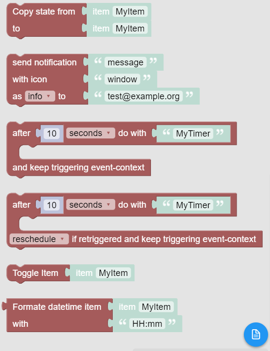

Blocks

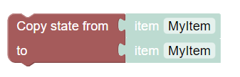

Copy state from <sourceItem> to <targetItem>
This block will replace the need of send Command(get state of item (sourceItem) to targetItem), will send the sourceItems current state as command to the targetItem with the purpose of having a more easy-to read code block.
Toggle <item>
This block will switch an item between ON and OFF state. If the item is already ON, it will send an OFF command. If the item has any other state (e.g. OFF or null) it will send an ON command
Send notification <message> with icon <icon> as <severity> to <recipient>
This block will extend the already existing send notification block with the option to also specify an icon and a severity when sending a notification to an individual recipient (the already existing block only supports this for broadcast & log messages).

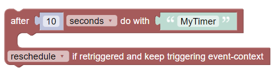

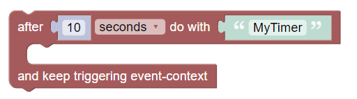

after <duration> <timeUnit> do with <timerName> <scriptAction> and keep triggering event-context
This block is an extension of the already available timer block and will pass the event variable as argument to the timer function, which will allow the timer to access the initial event (as the timer was initially scheduled), even the event has changed afterwards (e.g. the rule is triggered again by a different item). This topic will include a use case.
This block is also available with a reschedule / cancel option if retriggered.
Format datetime item <item> with <dateTime Format>
This block will use any dateTime item and return the datetime as a string formatted with a custom dateTime format.

              - - minutes
                - plusMinutes
              - - hours
                - plusHours
              - - days
                - plusDays
              - - weeks
                - plusWeeks
              - - months
                - plusMonths
            type: field_dropdown
          - check: String
            type: input_value
          - default: mail@demo
            type: input_statement
        colour: 0
        helpUrl: https://openhab-scripters.github.io/openhab-helper-libraries/Guides/Event%20Object%20Attributes.html
        inputsInline: true
        message0: after %1 %2 do with %3 %4 and keep triggering event-context
        nextStatement: ""
        previousStatement: ""
        tooltip: Schedules a new timer and will pass the event variable as argument to the timer, that you can reuse the initial event during timer execution (e.g. event.itemName)
        type: timerWithInitialEvent
        code:
          - component: BlockCodeTemplate
              template: >
                if (cache.private.exists[{{input:timer_name}}] === false || cache.private.get[{{input:timer_name}}].hasTerminated()){
                    cache.private.put([{{input:timer_name}}] = {{utility:scriptExecution}}.createTimerWithArgument([{{input:timer_name}}] , ({{utility:zdt}}.now().{{field:duration_unit}}({{input:duration}}),event, function (event) {
                  {{statements:timer_statement}}
        toolbox:
          - component: PresetInput
              fields:
                TEXT: MyTimer
              shadow: true
              type: text
              fields:
                NUM: 10
              shadow: true
              type: math_number

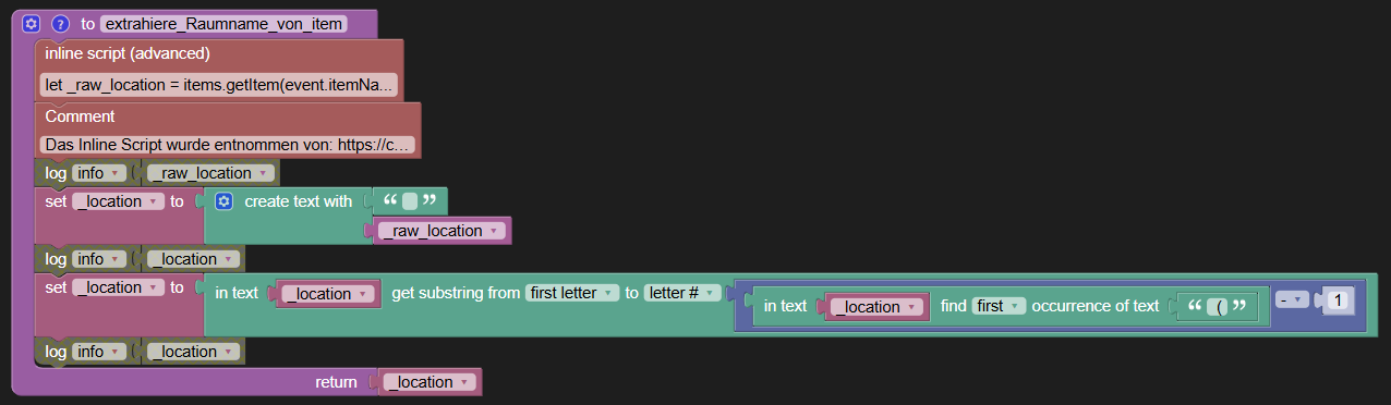

@Matze0211: I had a feature request :wink:
I think this is also usefull for many other people out there which want to know in which room an Item is located :wink:
“Room name from Item”
Input: ITEM
Output: Roomname
This is my latest workaround:
// Describe this function...
function extrahiere_Raumname_von_item() {
  let _raw_location = items.getItem(event.itemName).semantics.location;
  //Das Inline Script wurde entnommen von: https://community.openhab.org/t/getting-information-of-parent-equipment/151107
  _location = '' + String(_raw_location);
  _location = _location.slice(0, (_location.indexOf(' (') + 1) - 1);
  return _location;
