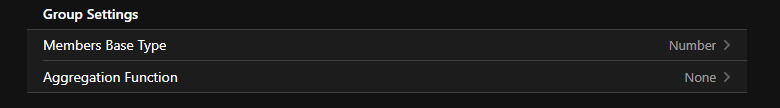

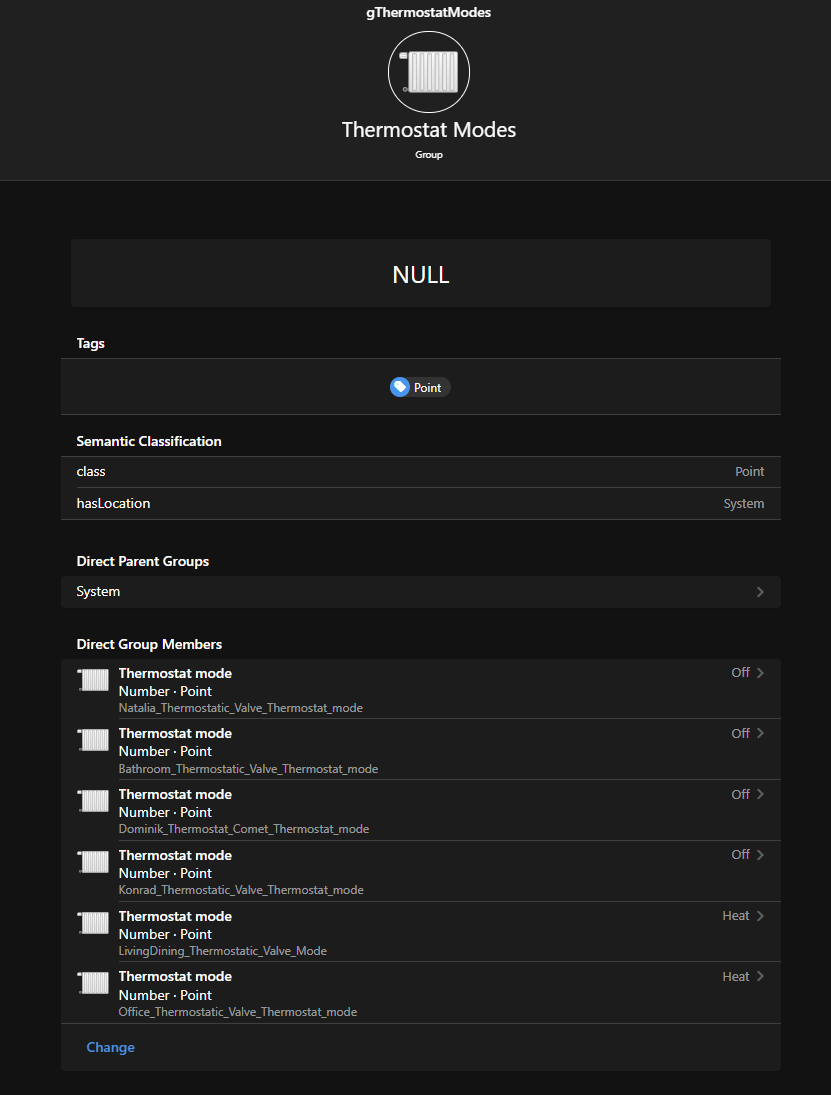

Something weird is going on then. It’s probably because your Group has neither a “Members Base Type” nor an Aggregation Function.
Without those the Item has no state.

There is no such thing as a “Selection” Item. As far as BasicUI is concerned a Group Item with a base type of Number is a Number Item and it will treat it as a Number in all ways.
If there is no aggregation function there is no State, so what exactly is BasicUI selecting?
What is providing the selection option s for the members of the Group? Do these have State Descriptions or some other formatting applied to them? Often the bindings will push State Description metadata to the Items. That won’t exist for Group Items so again, what is it selecting without that?

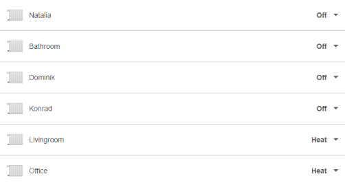

BasicUI shall enter the group of mode of different radiators and display individual status and selection for each of them. Exactly like in the picture below

Many sitemap elements, and I think Selection is one of them, requires the state so it knows what you are changing from in order to render properly.
And you’ve never shown the member configuration. It’s possible that those are being configured through the binding. You don’t have that advantage for the Group. You have to configure the mappings yourself. See Sitemaps | openHAB
