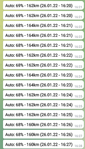

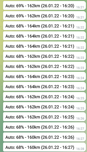

Also, when the car is moving there are constant updates:
However, when the car is parked there are pretty much none. I don’t know about when it’s charging, yet, but according to the comments above, updates are not sent regularly.

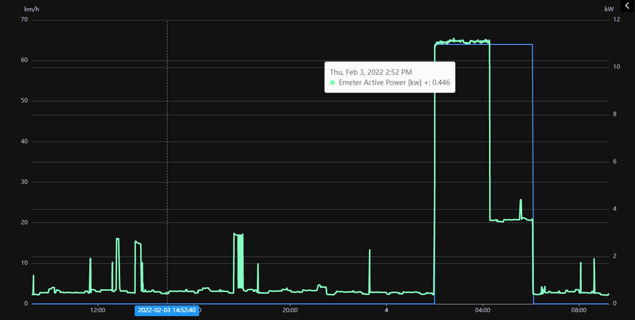

In the graph below, I’ve plotted the charging power (Green) and the “Charging Rate” (Blue).
Obviously the charging started on three phases, then went down to one phase charging as the batteries were getting a higher state of charge. But what does the “charging rate” really indicate?
It seems “binary”.
It represents the charging rate in km/h range
So 11kw will charge 64km range per hour
I dont know why it says 64km/h when its slowing down because of the SOC. My guess is that PSA doesn’t actively change that, but that this is a common number.
So 11kw = 64
7kw should then be around 42?
Fast charge 50kw should be 290?
Ahhh,
That makes sense. So they are using a consumption of approx. 1.7 kWh/10 km for the calculation.

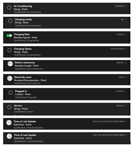

I just wanted to ask what channels you are getting populated?
Below are the ones I get, all others are “UNDEF”
