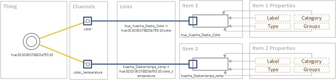

I think you did not get the concept of Things and Items. Let me show you something.
http://docs.openhab.org/concepts/images/thing-devices-1.png
So we have the “Hue Bridge” you configured in openHAB2 which is the Gateway for communication with the Hue Things.
You got an Inbox item like this
https://puu.sh/vEd0J/ce3c69759e.png
When added, in Configuration > Things you can see for the Colour Item the following Customisations.
https://puu.sh/vEdk7/58e3a7370b.png
This “Thing” the “Hue Colour light” has 1 “Channel” each “Channel” needs 1 Item so you can control the Channel.
If you wish to accomplish deeper knowledge checkout the openHAB Concepts or you go back to the openHAB root Eclipse Smarthome Documentation / Concepts
and because this is stuffed with pictures and knowledge already take this.

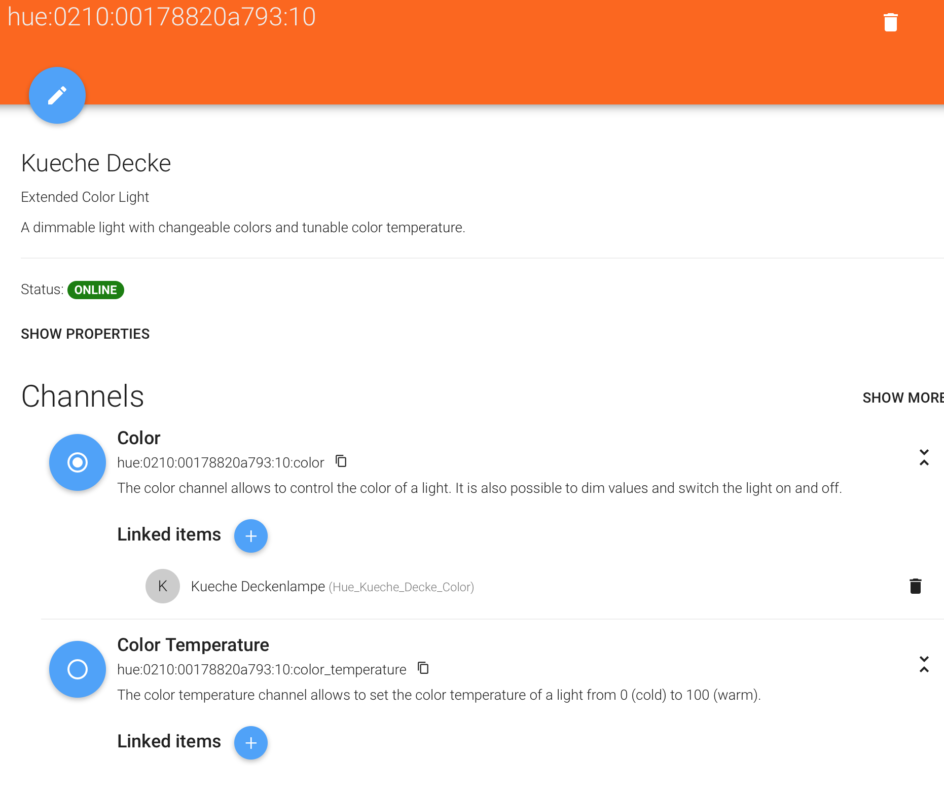

…but I have to ask again, because I am confused about…create 2 items via PaperUI…you mean 2 items for each lamp?
For example, the Thing “Hue Kueche Decke” needs 2 Items because it has two different characteristics?
…for Color I created this one:
and for Temperature, that one:
Color I can Link but Temp doesn’t appear in the DropDown. :frowning:
1 item per lamp (thing) channel and then you link each item to the proper thing channel

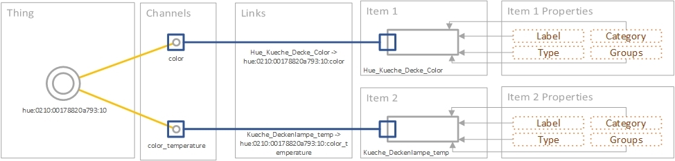

Since we use pictures… here you go :slight_smile:
[quote=“sinthom, post:11, topic:27729”]
[/quote]
Yes (because it has 2 channels).
Linking is done via the Thing, not by editing the properties of the item. The type property of the item should be “compatible” to the channel type that is being linked (see hue readme below).
For the specific item (color temp), use Dimmer item type. More details here: http://docs.openhab.org/addons/bindings/hue/readme.html. Your Hue lamp is thing type 0210 (see hue:0210…)
More info about item types can be found here: https://docs.openhab.org/concepts/items.html
Go in the Thing and Link the correct item to the channel by pressing the plus (+) sign under the channel name (where you see the “Linked items +”)
Ps: Yes, you could have multiple items linked to one channel of a thing but it’s not really useful.
Now it works! :slight_smile:
