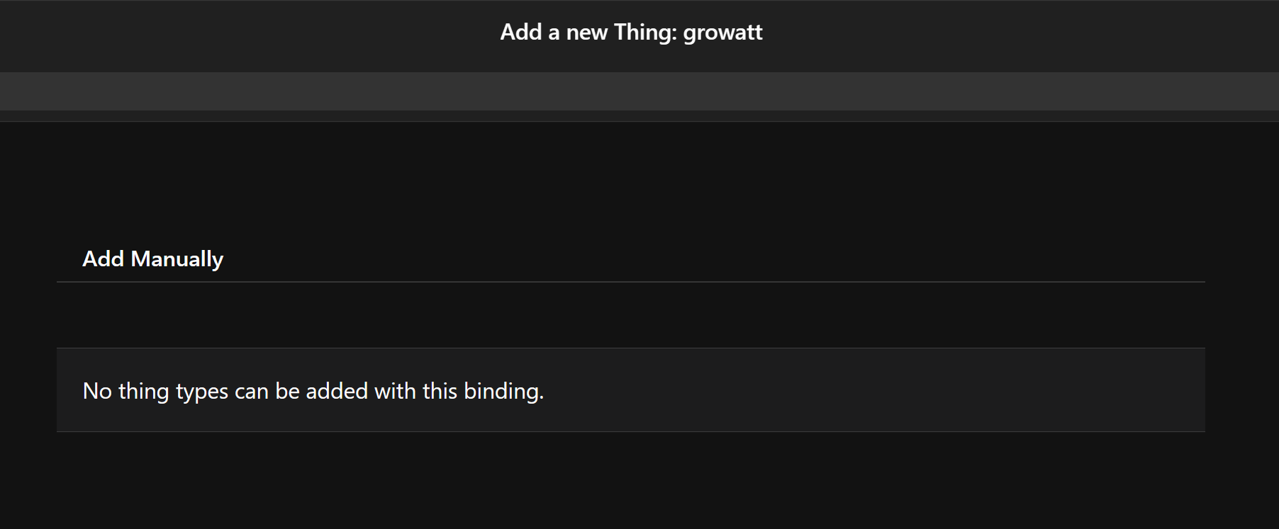

I have a questions:
  • how do you see the “bridge thing” and “inverter thing” or add the bridge thing?
    ->under “Add manually” it states “No thing types can be added with this binding.”

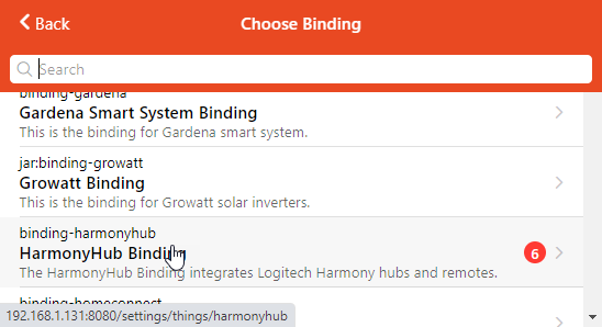

You create the bridge thing manually. Once the bridge thing is created, it will show status unknown. But once the grott application sends data to it, two things will happen 1) the bridge status will change to online, and 2) an inverter thing coresponding to the received data will appear in the Inbox (where you can then instantiate it).
Thanks for the answer.

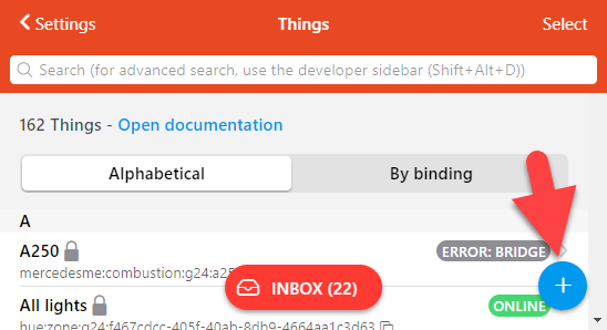

How do you create it manually?
Umm. I think via the + button at bottom right corner of Main UI things
Hi
I tried that, its not working.
Iam on version 4.0.4
What do you mean ‘its not working’?
Hi
when i do this the menu looks like this
no bridge or inverter thing to add.
Have uninstalled the binding and installed it again, no change
Could it be that something is wrong with the binding installation file from marketplace?
I have no idea.
I agree to Sebastian, there is no option to add things to the binding installed from marketplace.
If I am using the linked .jar file openhab is not recognizing the binding.
“The marketplace bundle was successfully installed but doesn’t start: Could not resolve module: org.openhab.binding.growatt [323]
Unresolved requirement: Import-Package: javax.measure; version=”[2.2.0,3.0.0)“”
The solution might be here (common issue with 4.1 versus 4.0.x)
You probably need to use a current milestone build.
https://github.com/openhab/openhab-core/pull/3758
