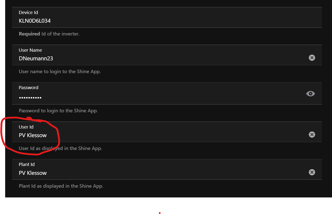

  1. If you did indeed have the correct credentials?
Maybe not. As I said your thing ask for 4 different data.
I am not sure about “User Id”

userId and plantId are numbers that identify you and your plant respectively. So the texts you show in your screenshot are not correct. However they are not required for this application. So that is not the cause of the error.
I compared the HTTP response from your system against mine. The command sequence comprises two HTTP calls: The first call is to login, which succeeds with HTTP 200 and gives the Json response which you posted in your log. The second call is to actually (try to) set the new battery program, and this fails with HTTP 500 and apparently no response content is logged.
