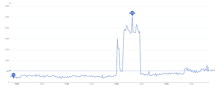

my house got 3 floors. Every floor is connected with a smart electricity meter.
I got a average consumption about 400W for the house summed up for all floors.
If I switch on a powerful consumer I can see the changing values for every floor. So identifying a large consumer is not that hard.
Finding a eg 30W consumer is not possible with this method. But what you can do is unplug all devices and plug in one by one. So will see the consumption without buying a smart socket for every device.
Here you can see what happens if someone is cooking a meal.

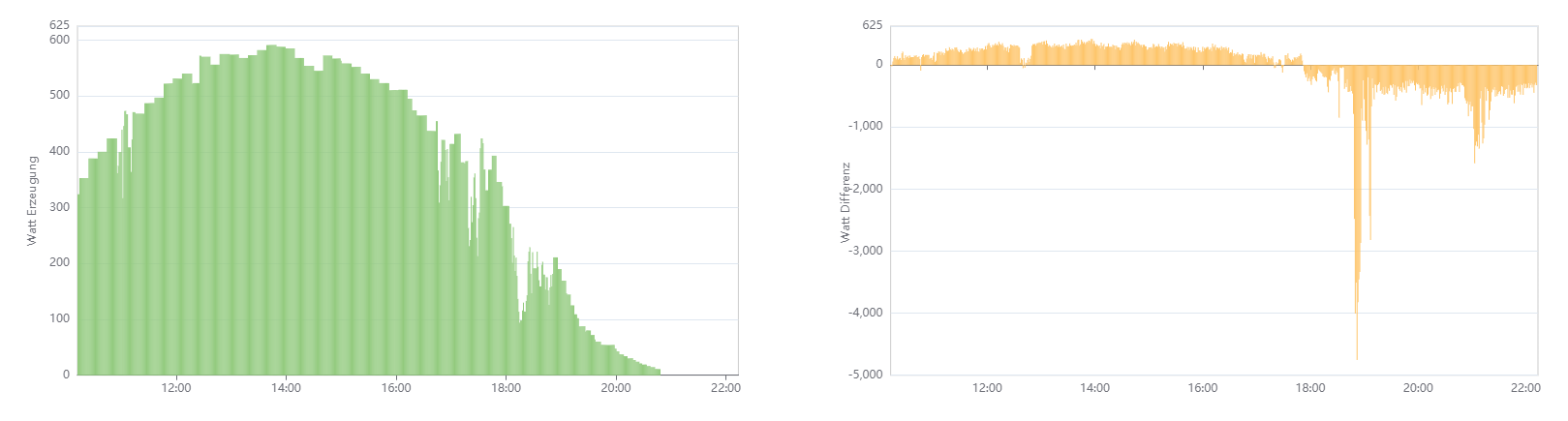

And here you can my power generation compared to my consumption.
Green is the energy from photvoltaik and yellow the consumption.
You can cleary see that the needed energy in yellow drops below zero when the sun sets.
(Above zero is excess, below zero is energy from my provider)
