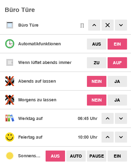

so i realized it in a different way, with the (habapp) self.run.on_every_day(time...
i only use the basic_ui, but i can set different times for each shutter, and depending if it is a holiday or a workday, looks like
for example the item i defined for a workday looks like:
Number iBuero_Fenster_Ro_opentime_work "Werktag auf[JS(numberToClock.js):%s]" <office>
(i do not mind but the only disatvantage could be that i only have one arrow to increase or decrease the time and so i set the steps to 15 minutes)

so i only have one trigger with the exact time to open the corresponding shutter
Ok, that would be also enough for me.
But never used these with listeners.
So I need to read about this things.
So your rule just watch the time items. If they change they trigger this python function, creates a new listener, and then if the time is reached the action happens?
yes, thats how i realized it for me to open my shutters in the morning. i didnt want to trigger a rule in timegaps 24/7 and always check if the time is reached to do the action. my rule only triggers to the desired time and then runs the action. the listener is only needed to be able to cancel, for exampke the desired time was 8:00 and you change your item to 8:30. without cancelling you would create a second listener and the action would run at 8:30 but also still at 8:00
