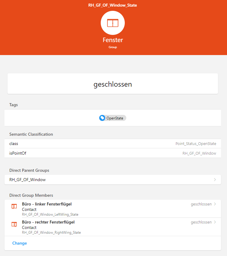

what is the smartest way to build a common state over group items. I would like to have an item that indicates, for example, whether all the lights (gLights) are off or all windows (gWindow) are closed.
A simple way is to group the items within a group. One example. I have on some windows windows contacts for the left and the right wing. So i creates a group with an Or function. So if one of the window wings is open the group (window) is open too.
Hello Thomas,
thanks, that helped a lot! The best rule is the one that is not needed! :smile:
