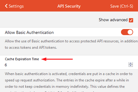

Seb, I just upgraded to OpenHab3, and had to do this change to get HABapp to work w. OH.
Run “ssh -p 8101 openhab@localhost”. Use password “habopen”.
Once inside the section, run "bundle:stop org.openhab.core.io.rest.auth:
I notice that your patch for OH is now merged. Does it mean that we don’t have to run the above command for OH 3.1 and above? However, we would still have to enable the Basic digest authentication for REST API in the Settngs UI.
What do you think about adding section for configuring OH? E.g.:
  • 2.5.x: no need to configure anything
  • 3.0.1 → 3.1.0: disable rest authentication as above.
  • 3.1.0+: enable Basic digest authentication for REST API in the Settngs UI and configure username and password in HABApp’s config.yml file.
Thanks,
Hai
In the 3.1.0 M3 the changes are already included.
If there is a Cache Expiration Time Parameter the requests will be speed up.
There is no need for any more commands, just activate basic auth.
good idea
