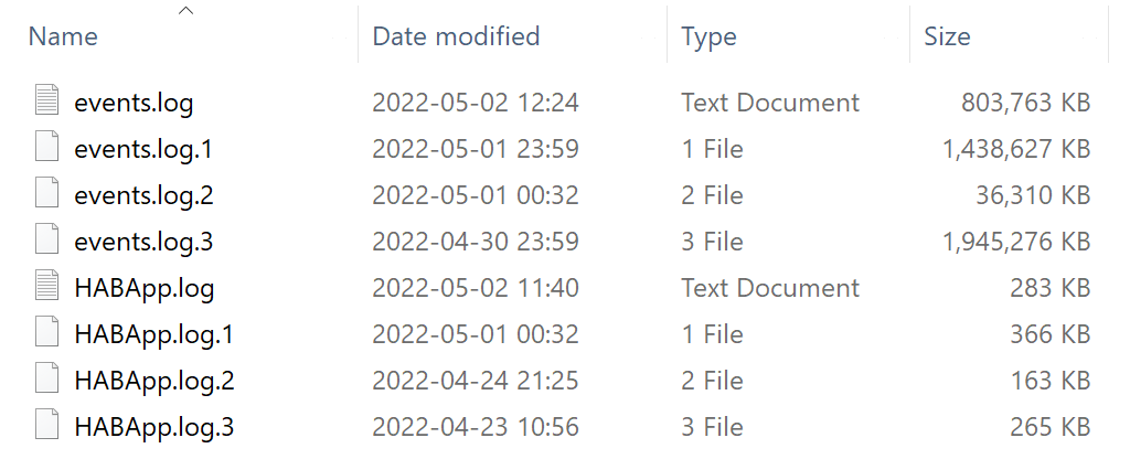

I need to get HABApp event logging under control. I’ve left it for a few months because I was busy with other things but now it’s time. You can see why if you look at the size of the event log and the timestamps. It’s literally gigabytes per day.
I’m having some other performance issues (occasionally simple functions take too long to run) which I suspect may be SSD wear – I will certainly replace the SSD but let’s fix logging first. :slight_smile:
I’m looking for something similar to putting a RegexFilter is log4j2.xml which does exactly what I’m looking for in openHAB.
Example:
<RegexFilter onMatch="DENY" onMismatch="ACCEPT" regex=".* (EnergyMeter|json_2Dtotal|HABApp_Ping).*"/>
Is there an equivalent way of using regular expressions in logging.yml?
If not, what’s the best way of replicating the functionality another way?
You can add a logging.Filter, in one of your rules and attach it to the corresponding logger.
An alternative would be to disable the event log altogether.
logging.Filter doesn’t seem to be similar – in fact, l don’t understand how it’s applicable at all. Every single event in events.log comes from HABApp.EventBus so how does filtering by the logger name ( ‘A.B’, ‘A.B.C’, ‘A.B.C.D’ etc) help?
I disabled the event log earlier today (or rather, I raised the log level to WARNING) and that at least stopped the flood, but of course now I don’t have av event log at all. It would be really useful it was possible to configure the EventBus logger with regular expressions to mark certain event names as “debug”, that way it would be possible to exclude them from the log without it completely disabling the log.
Anyway, I’ll keep it off for now, because even with it disabled, I’m still having some other performance issues, so they are obviously not event log related.

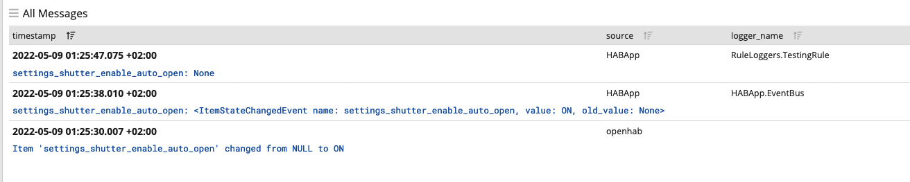

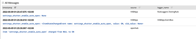

I’m facing since a while a strange Openhab/HabApp boot synchronisation issue. Depending on the boot sequence openhab items that are restored on startup do not have the correct value in HabApp. In Openhab the restored value is shown while Habapp still thinks the item is None.
As an example I have shown a sequence for one particular item.
The first event is from the openhab log. The next shows the event in Habapp and the last is a log output in a testing rule printing the value.
As you can see the update event reaches Habapp but for some reason the value is not updated.
The issue does not appear all the time but in most cases if I completly reboot the machine or all services. If I first start openhab, wait until it is running and then start Habapp everything is fine.
System:
  • All services running in container
  • Raspberry4
  • OH 3.3.0.M3
  • Habapp 0.31.2
Startup is really a pain. However thanks to @J-N-K with OH3.3 and the new HABApp Version all issues will be gone since he did some work on the RestAPI.
