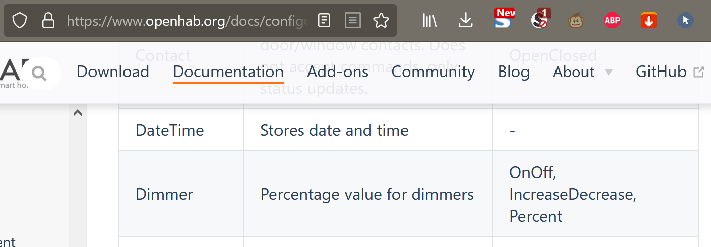

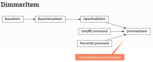

Okay, according to the openHAB documentation, dimmer items have an IncreaseDecrease command, which I assume increases or decreases the dimmer value in a single operation, rather than having to request current value, adjust value, and send the command back.
HABApp seems to lack this command, which means we do have to get_value, adjust, and oh_send_command. Is this an oversight? I would think this decreases performance. Or is it just not necessary?
It’s would be just oh_send_command('INCREASE') and it’s an oversight
