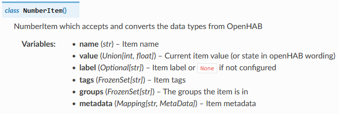

But, does it have to say ā€œOptionalā€? That still makes me think it’s something I may fill in, not something that comes from openHAB.
Not sure what the limits of the documentation generator are, but if the output was like this:
label (str) – Item Description
…that would be clear as day.
Actually, if we compare it with the ā€œParametersā€ description later on the same page, where you describe every comparison operation, I think it should be possible to add descriptions for all the Item class variables, which are a lot less obvious, at least to me. :slight_smile:

It’s the datatype of the variable. It’s an optional str, e.g. it can be None or an instance of str.
If you don’t configure a label in the item definition the attribute is None, else the string you configured.
Keeping the optional is crucial because it provides the information that it can be None
Should be doable - I’ll try to come up with something. For me it was so obvious what it’s supposed to be that I didn’t think a further description is necessary. Writing good docs is hard! :wink:
@leif Like this?
grafik

Your variables description is perfect! Nice job. Very clear.

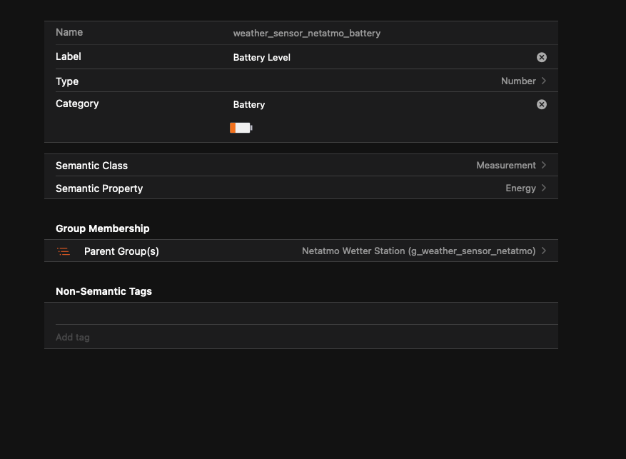

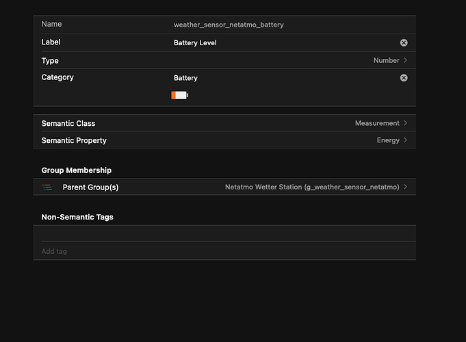

What do you mean with category? There is nothing in the docs about it
You can set the category in the create_item method in HABApp. If you leave it empty a potenially existing category will be removed. The category defines the icon shown in OpenHAB.
It can also be set via the UI (see attached screenshot)
openHAB — HABApp beta documentation has a parameter ā€œcategoryā€.
Which I guess refers to Categories | openHAB.
