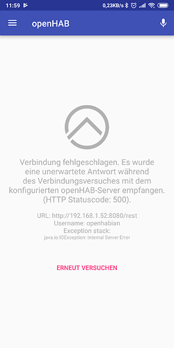

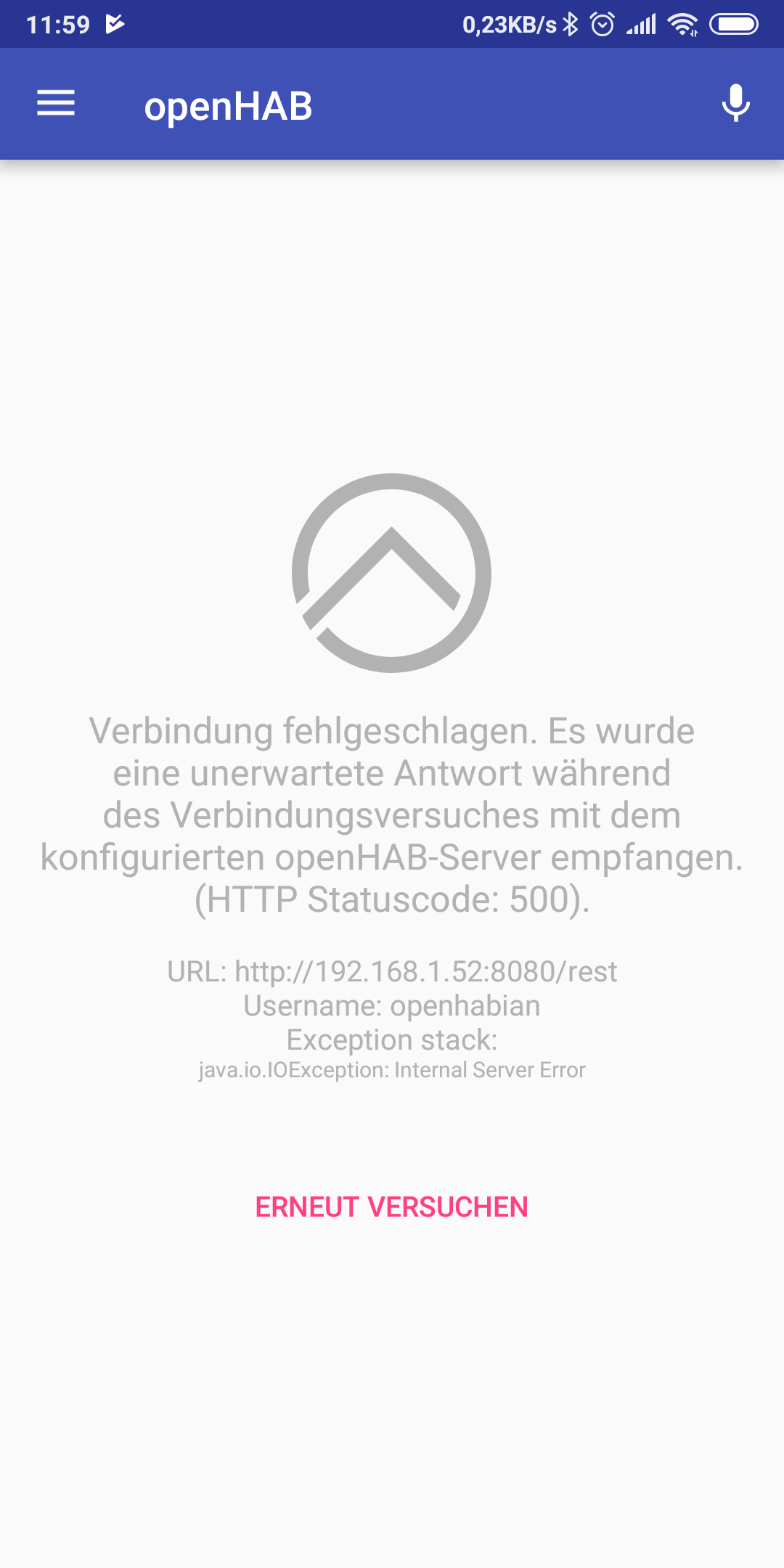

Since update 2.4.0 Remote-URL is not useable anymore! Error Message:
I checked it with Andoid 9 and Android 8 both shows this error after update.
Please refer this Thread for further information.: Status Code 500 with OpenHab App

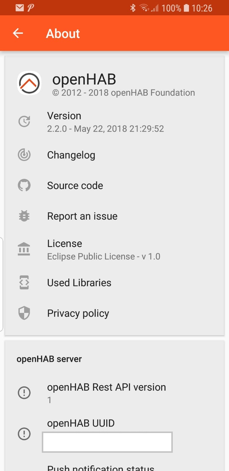

can you post a screenshot of About:
(hide your UUID)
You may have to open up an issue on Gihub for this one (not sure)
Here the Requestet Information:

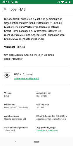

Also a Shot frome the German Playstore App (in the Desktop-Browser I see V2.2.0 too

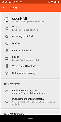

Can you enable debug mode in the settings and post a screenshot of the stacktrace?

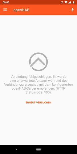

Same problem here. Until 2.2.0 everything is working fine, after update either stable 2.4.0 or 2.5.0 or beta I get the same error. After downgrade to 2.2.0 it’s working again
How can I supply more information?
