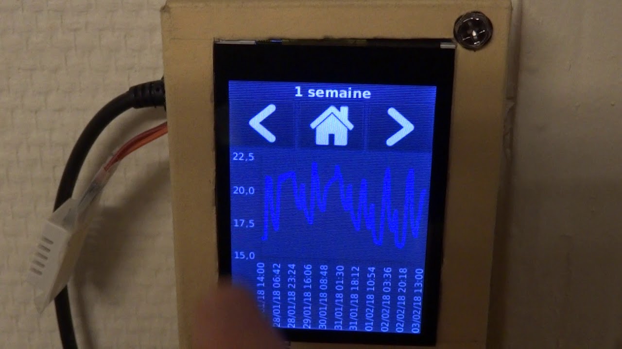

I have made an openHAB 2 client for my personal needs. It may be useful for other user.
I have design it for very small touch screen. I actually use it with an adafruit PiTFT of 2.8" (320x240) plugged on a Raspberry Pi 3, but it can run on any system with JavaFX 8.
I think that it is a nice wall screen :wink:
http://habfx-ui.ben12.eu
Note: For Raspberry Pi, you must install the JavaFX Embedded SDK for armv6 and use Framebuffer “fbcp” (see: GitHub - ben12/my-habfx-ui: My OpenHab JavaFX UI plugins)
