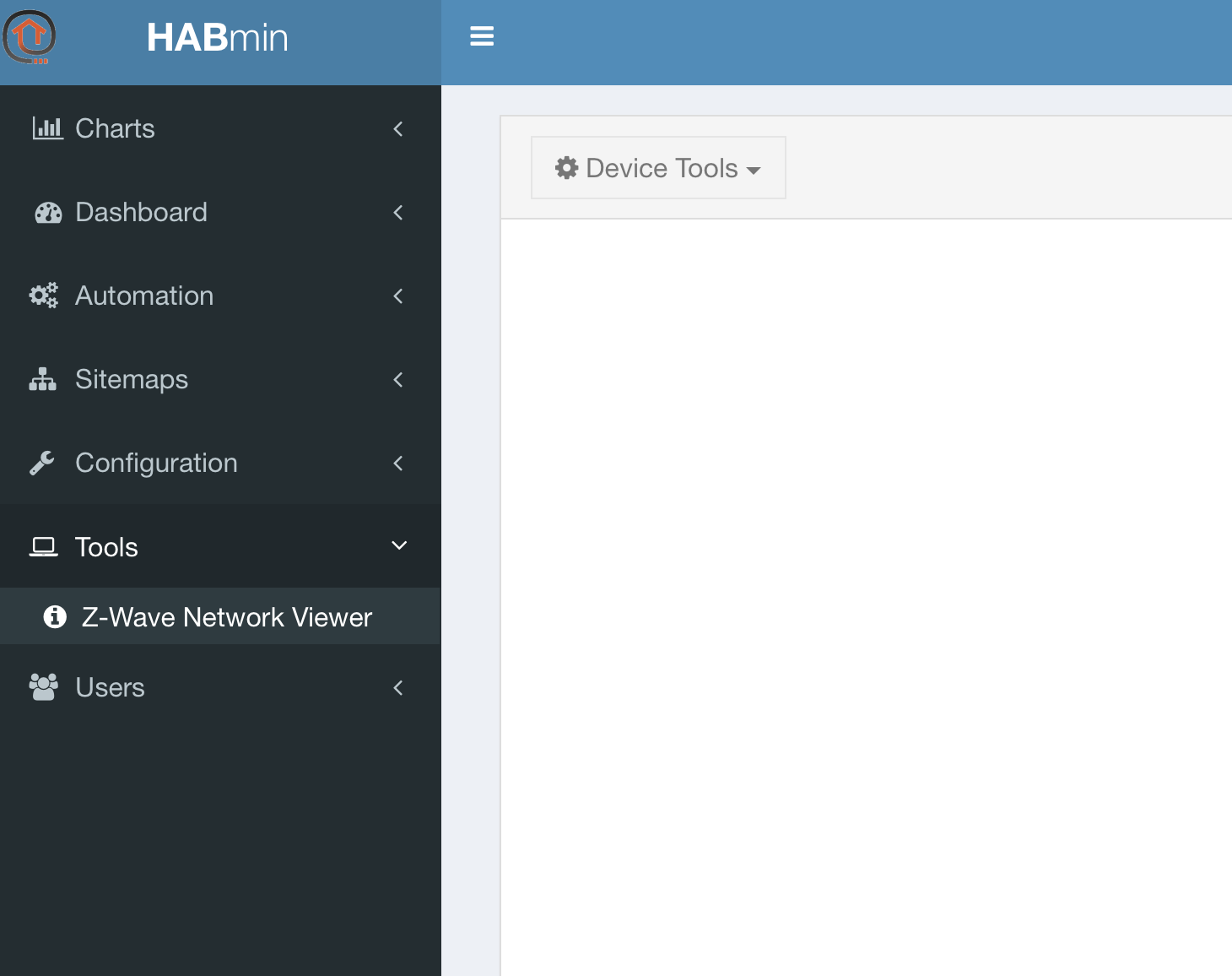

There are a few (seemingly related) issues, but the main one is the Wave network display; if I try to use the “zwave network viewer”->Device Tools menu, the cursor changes to a “no entry” and nothing is clickable, and nothing in my mini zwave network appears. I have checked the zwave nodes and they show neighbours and seem to work when controlled from the paperui.

Yes,I am familiar with GitHub, the confusion is the current Habmin screen does not say what version it is, and it does not look anything like the habmin2 screenshots I’ve seen (at least for the zwave list). To me it is saying, you have an old version of Habmin - go here to download the newest version.
My OH 2.4 Habmin looks like

Included below are the zwave Things and the Habpanel view. The zwave devices seem to be working okay they are networked together as listed in their respective properties. They are controllable and report to the main controller.
The habpanel is blank, and the options button is not selectable.
