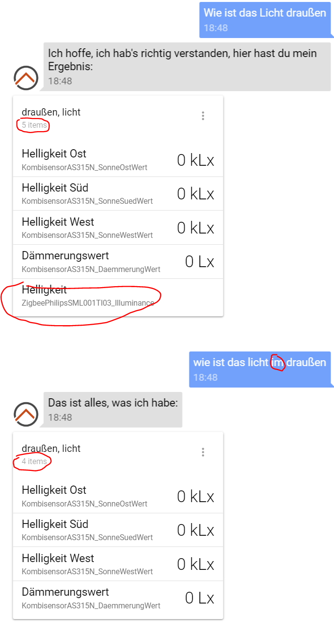

Probably something else to consider for the NLP (at least for the German):
(notice synonym “draußen” for "Garden)
Group   gGarten     	"Garten"                <garden>            (All)    	["Garden"]      {synonyms="draußen"}

Number    ZigbeePhilipsSML001TI03_Illuminance    "Helligkeit [%.0f Lm]"    (gBuero,gIlluminance) ["Light","Measurement"] {channel="zigbee:...."]
The synonym works, but if you ask as you would usually do in German, it catches one additional item which does not belong to location “Garden” a.k.a. “draußen”. If you ask for “Licht im draußen” (nobody would say this in German :wink: ), it brings the expected results:
I guess there are a lot of similar cases to get “teached” to achieve a good experience :wink:
