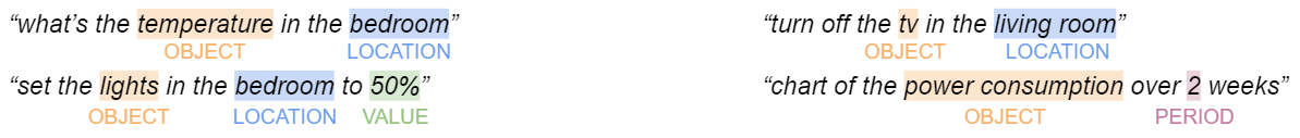

One of the components of the natural language processing in HABot’s case apart from intent classification is the entity extraction, that is, extracting the important parts of the sentence and determining their type.
A lot of training focuses on sentences containing “<what> in the <where>”, which will be extracted in entities with the object (“what”) and location (“where”) types.
Note that “object” is not in ESH’s ontology; for technical and historical reasons, HABot is unable to distinguish between equipments, points and properties, therefore an object in HABot’s terminology can refer indifferently to a Equipment, Point or Property as defined in ESH’s ontology.

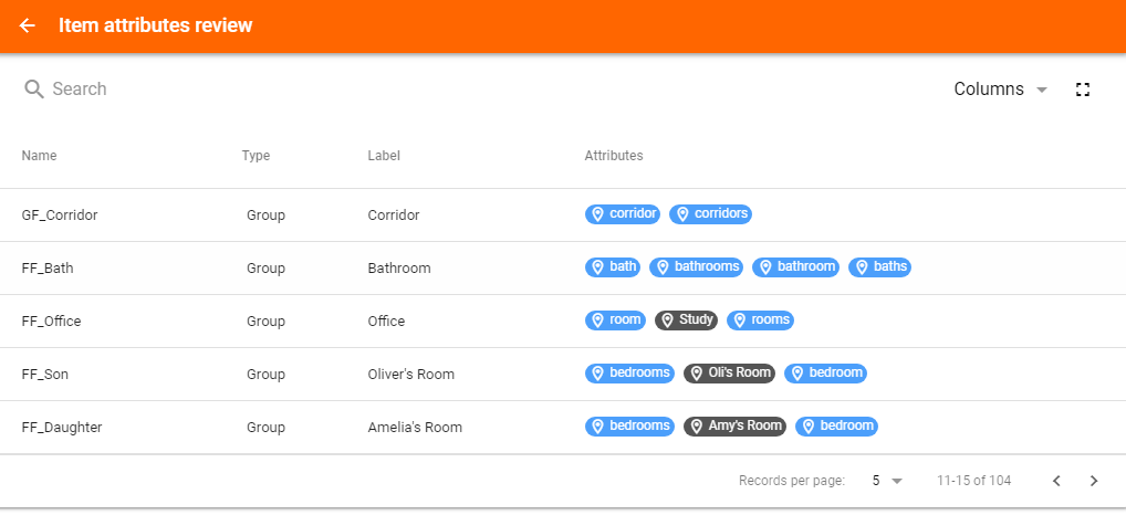

Terms associated with individual items apart from its label are called “(named) attributes” in HABot’s terminology for the same reasons; in other words, attributes are what HABot considers how each item can be referred to. When chatting, the interpreter will resolve items from the entities extracted from the sentence (object=Lights, location=Kitchen) by looking at items and their attributes.
You can review which attributes are associated with your items in HABot’s UI: click on Settings in the sidebar, then the View item attributes option:
The chips in the last column indicate whether the attribute is an object or a location (with icons), and whether it comes from a tag (in blue) or a synonym defined with metadata (in black). Remember, the label is also automatically considered.

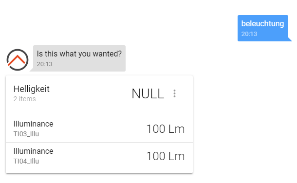

Deploying goups for assigning “points” and “properties” to items seems not working.
This works (notice the synonyms at the end of the line):
Number TI03_Illu  "Illuminance [%.0f Lm]"    (gBuero) ["Light"] channel="zigbee:xx:yy:illuminance",synonyms="Helligkeit,Beleuchtung,Lichtintensität"}
But I’d rather like to have the synonyms defined just once for all sensors, e.g. (not working!):
Group   gIlluminance    "Helligkeit"   <status>    ["Light"]   {synonyms="Helligkeit,Beleuchtung,Lichtintensität"}
Number   TI03_Illu    "Illuminance [%.0f Lm]"    (gBuero, gIlluminance) {channel="zigbee:xx:yy:illuminance"}
to avoid repititions of the same code.
Is there a way of doing this already?
No, sorry, previous iterations allowed these automatic group inheritance scenarios but since the introduction of the semantics in ESH, it’s more controlled and not possible anymore - so you have to specify the synonyms for all items.
But if a query matches group items, normally they should be expanded…
Thanks a lot Yannick - and: Happy new year! :wink:
Your answer let me start thinking about the group inheritance for points and properties and their synonyms:
Was’nt sure, if I got you right here, so I’ve just gave it a try.
And indeed, the following IS WORKING:
(notice “Light” is directly tagged to the item AND is tagged to inherited group gIlluminance too)
Number   TI03_Illu    "Illuminance [%.0f Lm]"    (gBuero, gIlluminance) ["Light"] {channel="zigbee:xx:yy:illuminance"}
Yes, I can still use the synonyms for “Light” to query the illuminance item :slight_smile:
Sure, this brings some redundant configuration since the property “Light” is assigned to the item directly AND is inherited through the group gIlluminance. I’ve understood, that the property “Light” has to be assigned on the actual item directly.
But: In contrast to my former try, this configuration brings me the expansion of the synonyms for “Light” through the group inheritance.
Means: My list of synonyms has just to be maintained in one place instead on multiple items.
This is great!
Thanks for bringing me to think about this!
:wink:
Happy new year too! Glad you got it working!
However I even think the tags are not necessary, i.e. I just tried what you previously said is not working, and it does in fact work for me:
Number   TI03_Illu    "Illuminance [%.0f Lm]"    (gIlluminance)
Number   TI04_Illu    "Illuminance [%.0f Lm]"    (gIlluminance)
So I don’t know why it wasn’t working before.
A disclaimer: Note that the fact that a group is expanded when referred to like this a feature specific to HABot, not a feature of ESH semantics. Other clients relying on the semantics might not implement this behavior, so it’s safer to at least tag all items with the proper semantic tag like intended.
Thanks for your investigations…
Mmh. Just checked, it’s working here too now without the explicit tagging on the item level :wink:
So I’m happy with HABot for that :wink:
To sum up:
  1. For HABot I can leverage the group inheritance for assigning all the four semantic tag-types (location/points/properties/equipment) as well as for my own synonyms.
  2. For possible other semantic-based bundles, I have to add individual tags on the items.
  3. If I do both above, I stay at least “compatible” with HABot and others while probably (certainly?) not having the synonyms available for the “non-HABot” semantic clients as long as I do not replicate the synonyms to each and every affected item.
Right so far?
Yes, you’re exactly right.

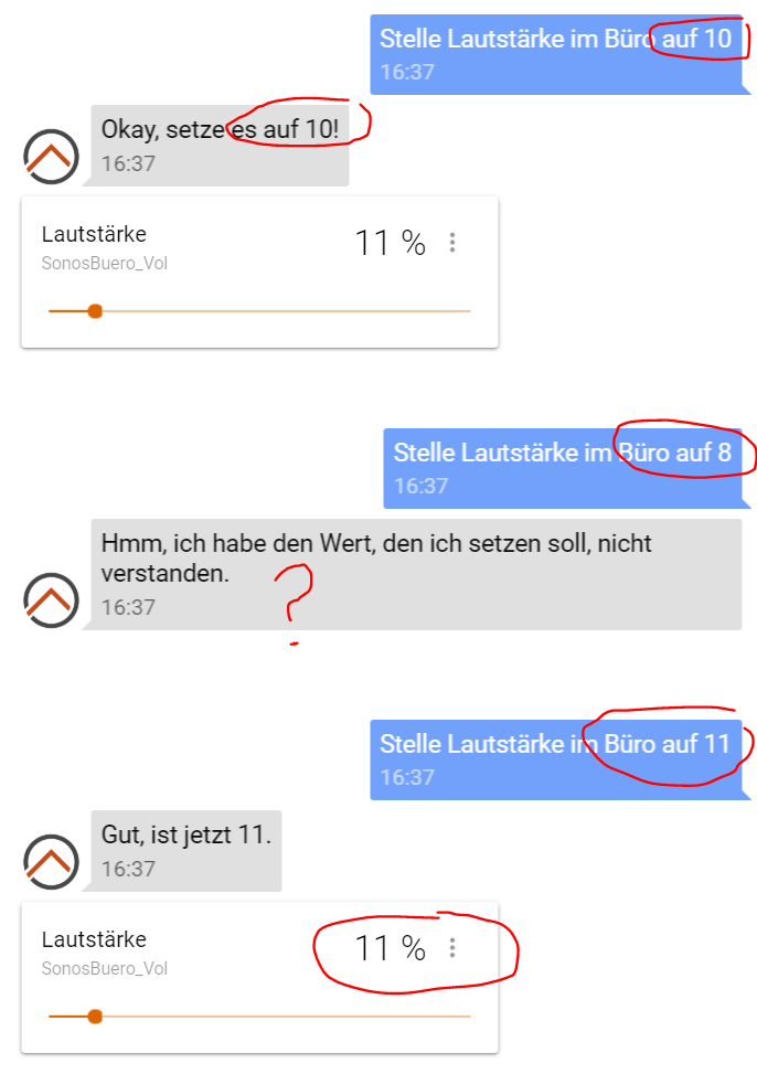

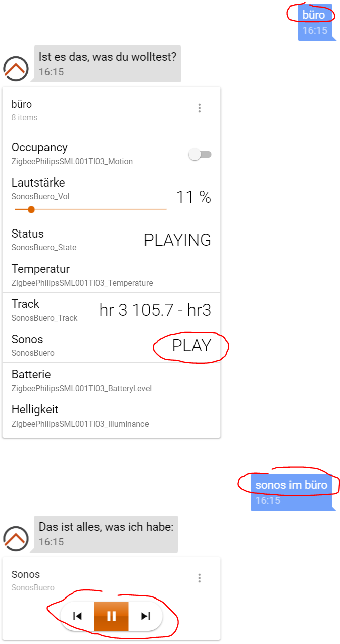

Just tried to get some of my Sonos items tagged:
Group   gBuero	     		"Büro" 			                <office> 	    (gOG)           ["Room"]         {synonyms="Arbeitszimmer,Büro,Gästezimmer"}
Group	gSonosBuero											<receiver>      (gSonos)                            ["Receiver"]
Player 	SonosBuero			"Sonos"					        <receiver>      (gBuero,gSonosBuero,gSonosPlayer) 	["Control"]	{  channel="sonos:PLAY5:Buero:control" }
String  SonosBuero_State    "Status [%s]"                   <receiver>      (gBuero,gSonosBuero,gSonosState)    ["Status"]  {  channel="sonos:PLAY5:Buero:state" }
Dimmer	SonosBuero_Vol		"Lautstärke [%.0f %%]"			<soundvolume>   (gBuero,gSonosBuero,gSonosVol)	    ["Control"]	{  channel="sonos:PLAY5:Buero:volume" }
Dimmer	SonosBuero_NVol		"Durchsagelautst. [%.0f %%]" 	                (gBuero,gSonosBuero,gSonosNVol)
String	SonosBuero_Radio	"Radio [%.16s]"					                (gBuero,gSonosBuero,gSonosRadio)	 	        {  channel="sonos:PLAY5:Buero:radio" }
String	SonosBuero_Track	"Track [%.16s]"					                (gBuero,gSonosBuero)	            ["Status"] 	{  channel="sonos:PLAY5:Buero:currenttrack" }
First of all I noticed, that the widget/card is rendered differently when queried through the location group or individually. In the first case, just the state (play/pause etc.) is shown but no control widget is rendered. In the latter case, the expected widget is shown:
It’s not that important for now, but though I’m curious to know where this came from?
Second thing I’ve discovered:
HABot seems not to like values less than 10 :smile: :smile: :smile:
See:
Any idea what’s the reason for this?

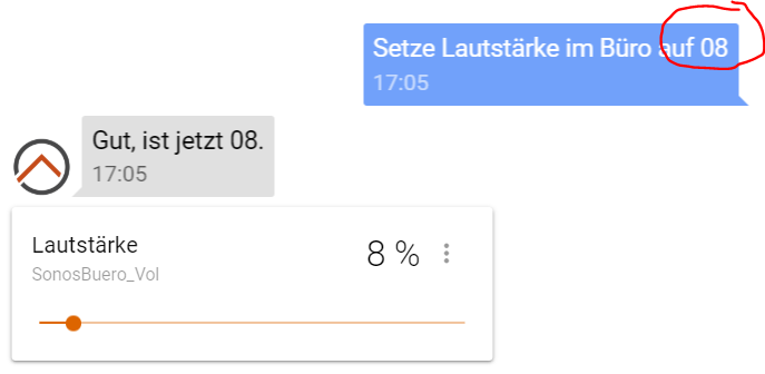

Edit:
When I enter single digit number as two-digit (“8” → “08”), then the value is accepted:
