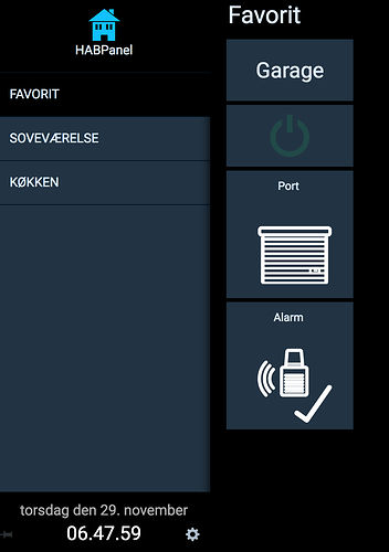

I started playing a little with HABpanel. As my design is now, I have a push button to trigger my garage door to open and close, respectively. Below I have a ‘dummy’ showing the status of a switch that shows if the garage door is open or closed. There are 2 different resource IDs, one to trigger the actual open / close feature and another to display the status.
My question now is whether I can somehow integrate the pushbutton into the same icon that shows the status of the garage door to avoid having the green switch icon above. So I just press the icon that shows the status of the garage door, which sends the ON command that the green pushbutton does now ?

Here is the two items. First - the button, second - the state (is the door open or closed)
Switch   Garage_PortOpNed          "Port"                                          <garagedoor-50>              {channel="ihc:controller:74ee5efb:input25558106"}
Switch   AlarmGar_Totalalarm       "Status Totalalarm Garage [MAP(alstat.map):%s]" <al>                         {channel="ihc:controller:74ee5efb:output16736859"}
