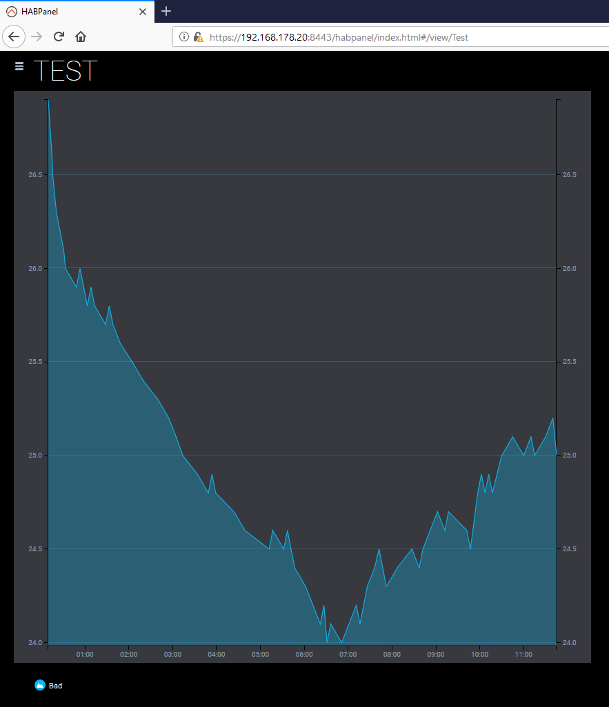

I have a weird situation where all my chart widgets in my HABpanel goes larger and larger.
When I load the page the chart widget looks like this:

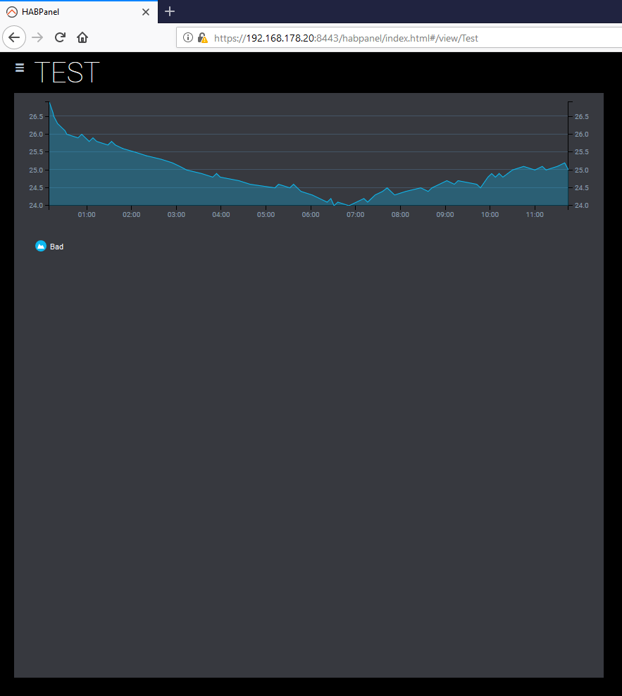

After waiting a minute it looks like this:

Strange! Never experienced this, it seems you have added additional CSS, can you try removing it temporarily to see if it still happens without it?

Yannick, you are brilliant! Thanks a lot!
I removed my whole custom CSS and it was fixed.
I have to analyze which CSS code exactly leads to this issue and then I will post the solution here.

Hi, having the same problem. Did You find the reason? Thanks, L

Hi Lukas
I deleted my whole custom CSS and created it from scratch.
There was an issue in the CSS but I couldn’t find what exactly caused it.
What was very helpful for me was to use the webbrowser’s console which logged the issue.
