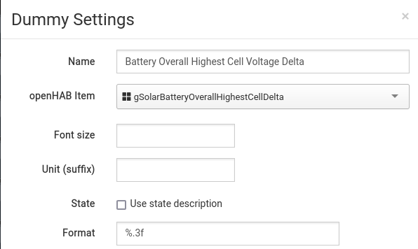

I’m trying to specify a format in the HAPPanel standard dummy widget, but as soon as I specify a format, the widget does not show a value.

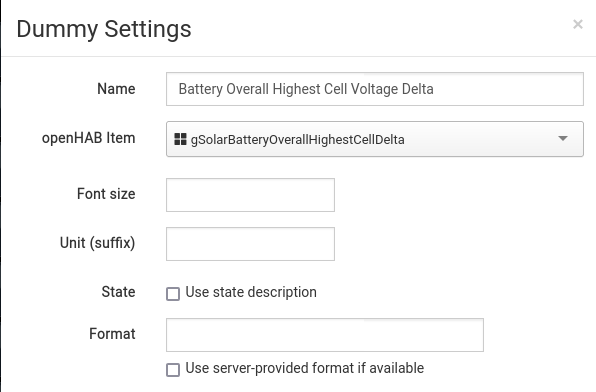

The working widget showing a value:
with it’s settings:
And here the widget with the format specified as %.3f and it’s showing no value (I’m using the same formatting to show all individual cell voltages and this works). It’s just showing the Name and it has nothing to do with the size and also I’ve tried different float formatting without success.
