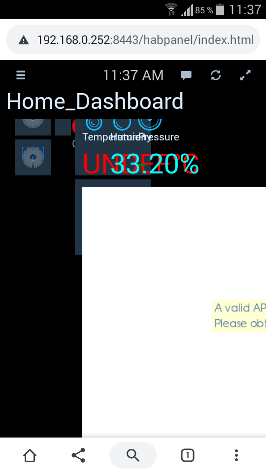

If the display of icons and fonts on my MAC Browser looks OK, the same display on my IOS and Android Iphones are awful, not only the icons the the font as well.
Where is it possible to configures OpneHAb2 fonts and icons, to ensure auto adjust according to the size of the device it is displayed?

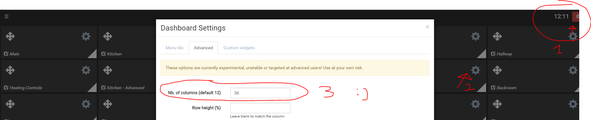

First thing to do though on a new pain, go into settings and change the “rows” value from default (12 IIRC) to something like 36 or 48. That allows you to make a much denser screen.
It could do with some polishing (I wish I could help with that!) but it does work.
Thanks for your answer but I am not too familiar in creating dashboards, so I believe I will have to practice a little bit more before asking pertinent questions in order to tune my panel.
NB: I couldn’t find any reference the default 12 rows but well default 12 columns, is it that that you recommend?
Forgive my paint skills :slight_smile:
On the main screen, select the settings gear, then the settings gear for a dashboard then Advanced and change the column count. It allows smaller tiles which are actually better suited.

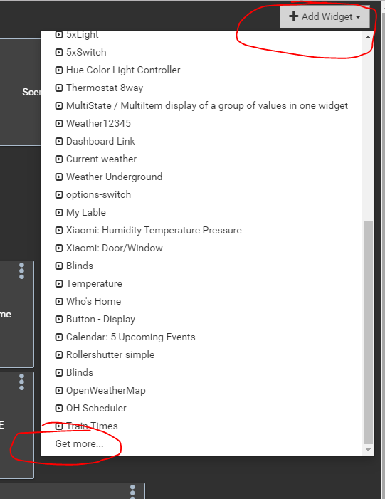

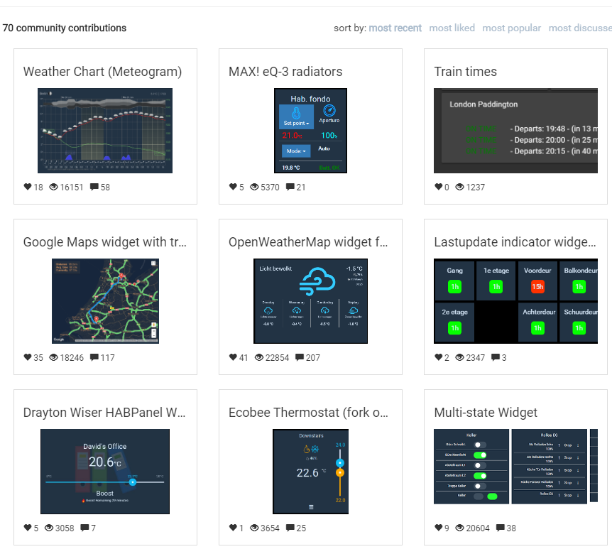

What I did find useful is google images. Search for Habpanel and then browse images. I got loads of ideas from there of what works.
What I would love is if there was an easy way for people to share widgets via a single click (click to publish) I see so many brilliant widgets and which I had the skills to remake those.
Another good source is:
Shows you the (ageing :frowning: ) gallery
Those give you a good starting point to take something and bend it to suit your needs.
