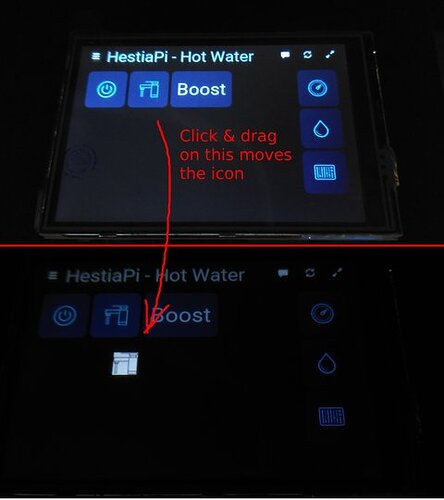

I have a HABPanel UI with a some buttons/switches/dummies running off a RasPi Zero and displayed in an 3.5" touch-screen.
Fairly easily, as the buttons are as big as my finger, if I try to simply touch a button or a switch, the backdrop (background) icon is actually getting selected and dragged outside the box of the button leaving it floating where my finger registers the touchend event (finger leaves the screen) in grey colour and white background. Using a stylus is easily reproducible. See image:
This happens only on the LCD screen. If I visit the same page from my laptop and intentionally click&drag, nothing happens (as expected).
Additionally, if I do the same on a text-only button, nothing happens.
Any suggestions to disable this?
This was fixed for some time but it came back.
